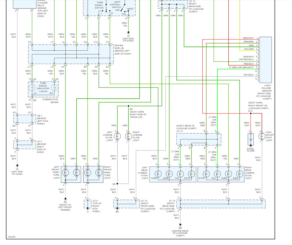

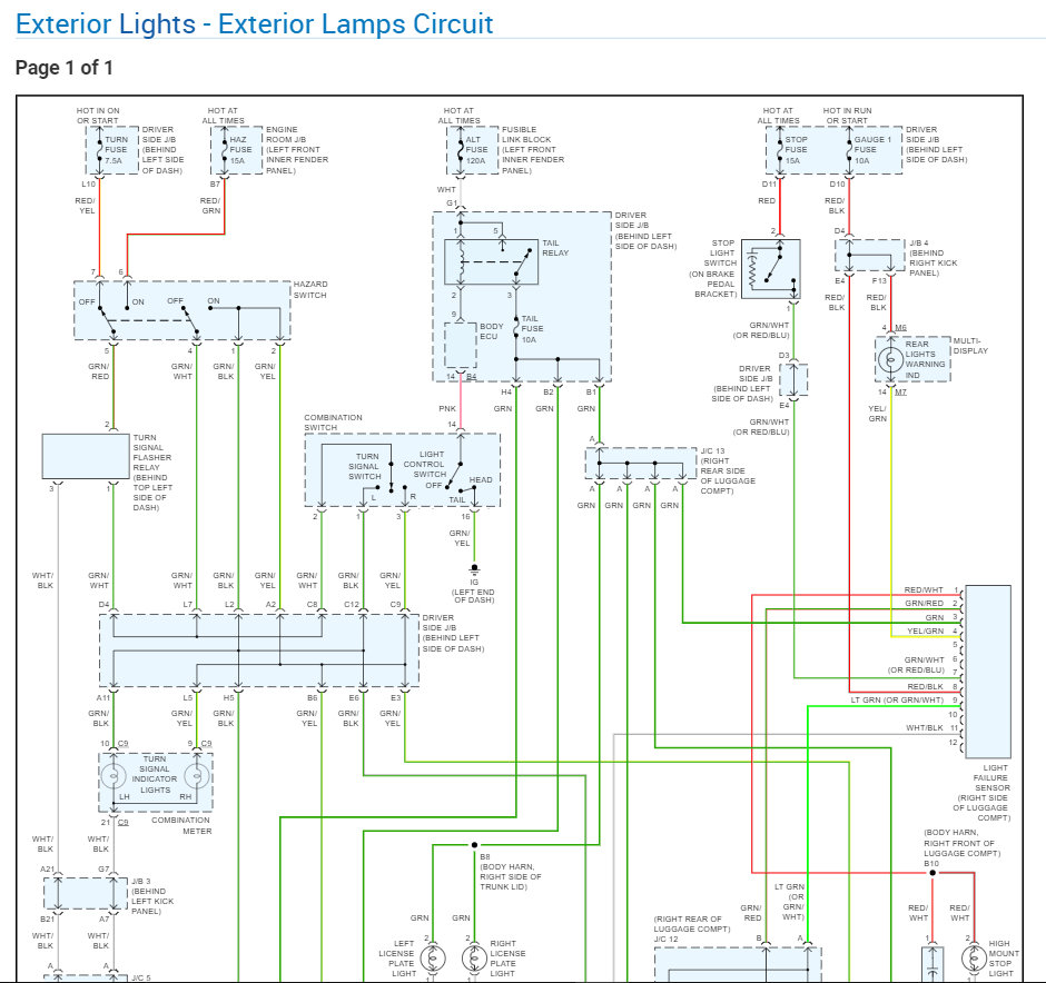

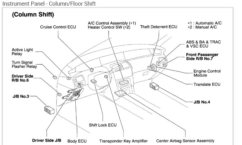

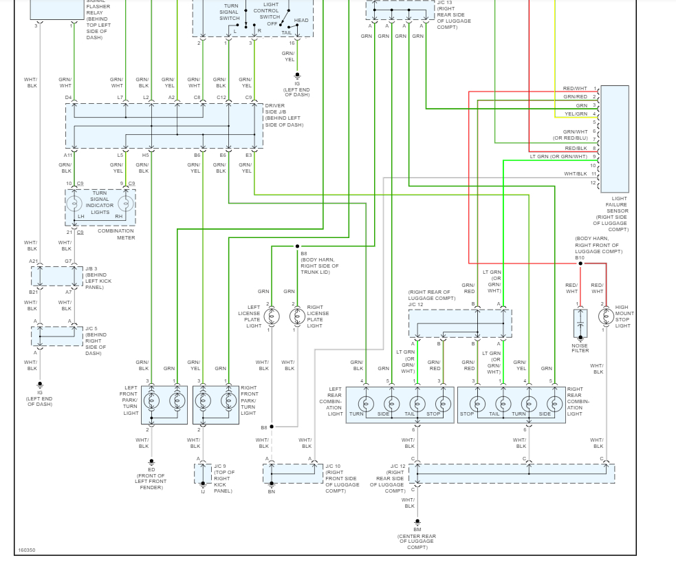

I want to replace my turn signal flasher with a louder one. I can hear it clicking in the driver's side kick panel, but cannot see it. I have removed the lower block of connectors without spotting it but have not been able to remove the other blocks without apparent need to disassemble half of the dashboard. How do I get at the flasher?
Friday, October 22nd, 2010 AT 11:05 AM
SATURNTECH9
  • 30,869 POSTS
The turn signal flasher is located behind the dash on the drivers side. Here is the blinker wiring diagrams so you can see how the system works and the flasher location below.
Cheers
