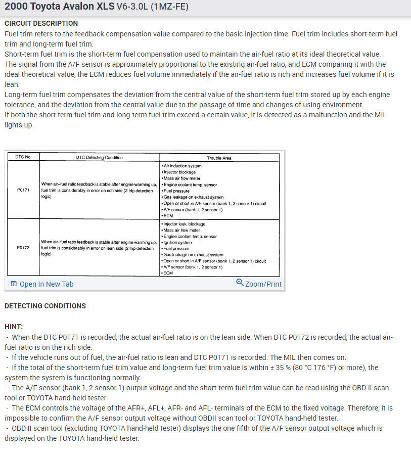

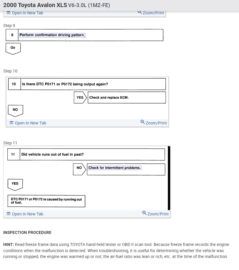

I have a computer code after I scanned my Avalon XLS. It is P0171 system is too lean on bank one
Jul 27, 2009 at 11:44 AM
SQM
  • 6,383 POSTS

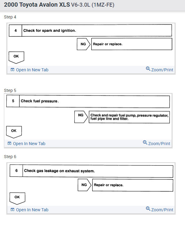

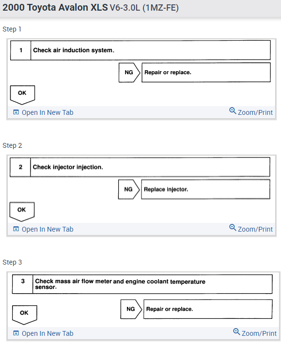

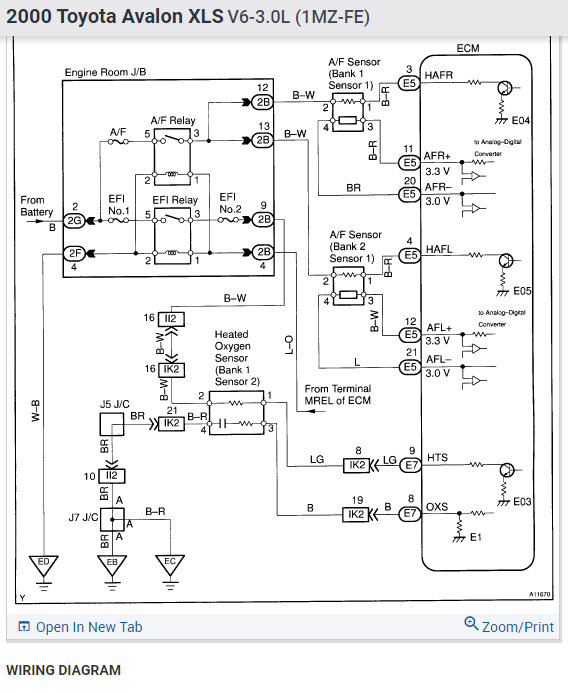

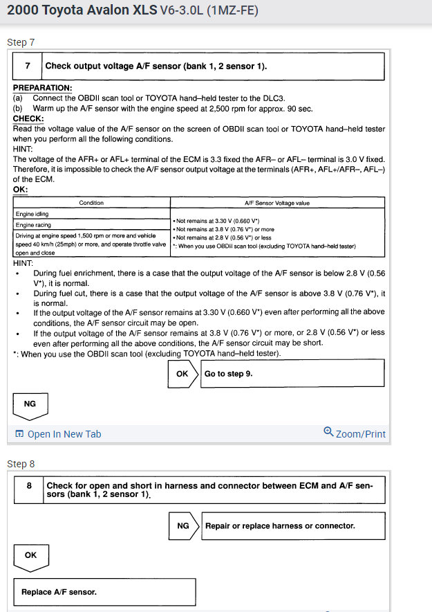

This code P0171 can be triggered by simply a oxygen sensor. However it can be the reason of few other issues as well.
Could be due to restriction in the air induction system.
Blockage in the injector.
Faulty Mass air flow sensor.
Fuel pressure.
https://www.2carpros.com/articles/how-to-test-an-oxygen-sensor-02-sensor
https://www.2carpros.com/articles/how-to-replace-an-oxygen-sensor

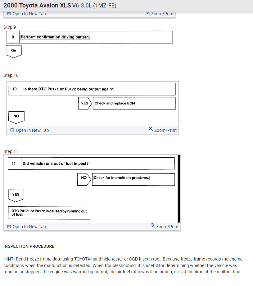

I have attached the diagnostics for that code. This will help you determine the issue and pin point the problem.
