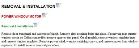

I have a new window motor and want to be sure I do the right things when I take the panel off and replace it. Can you point me to the appropriate procedure?

https://images.2carpros.com/forum/automotive_pictures/261618_Noname_1179.jpg
