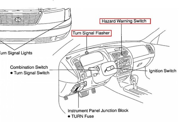

My blinkers just stopped working my hazards work fine but the turn signals just stopped . i checked the fuses for the turn signals they were fine but i replaced it anyways just in case and they still dont work .
I need some help

did you check the 7.5amp fuse turn signal fuse? If that is ok then you need to check powers and grounds.
Could just be the turn signal flasher..
Location is attached below
