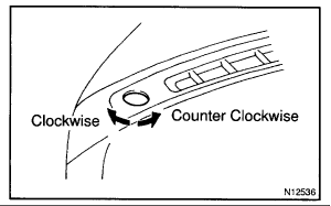

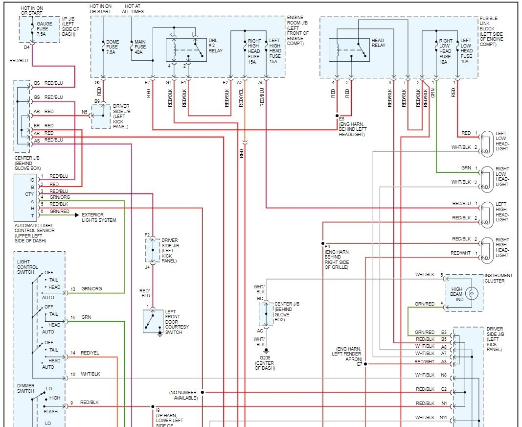

my car was parked in the driveway suddenly the headlights went on, i got in the car and tried to turn them off (the were not on when last I left the car) turning the light switch on & off several times had no effect. I finally disconnected the battery to turn the lights off , so that I did not kill the battery. Whats wrong ?

INSPECT AUTOMATIC LIGHT CONTROL AUTO OFF: Gradually expose the sensor. Make sure that the lights should turn OFF the headlights and accessory lights. 3. INSPECT LIGHTS-OFF CONDITION Turn the ignition switch ON . Gradually cover the top of the sensor. Lights auto ON : Make sure that the lights will go out when the light control switch is OFF , the area surrounding the sensor gets bright or open the driver's door while the ignition switch is OFF . 4. INSPECT LIGHTS-ON CONDITION Open the driver's door while the ignition switch is OFF . Turn the light control switch to AUTO leaving the door open and cover the top of the sensor, make sure that the lights go on when the ignition switch is turned ON . 5. ADJUST AUTOMATIC LIGHT CONTROL SENSOR Adjustment of the light control is performed by turning the sensitivity knob on the sensor.
https://images.2carpros.com/forum/automotive_pictures/248015_3_30.gif
This will be determined at what light condition the automatic control will take place. If response is too quick. turn the knob counterclockwise. If response is too slow, turn the knob clockwise. 6. INSPECT SENSOR CIRCUIT

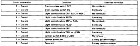

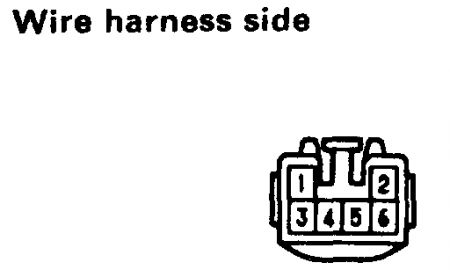

https://images.2carpros.com/forum/automotive_pictures/248015_4_20.jpg
https://images.2carpros.com/forum/automotive_pictures/248015_5_14.jpg
Connector Disconnected Disconnect the connector from the sensor and inspect the connector on the wire harness side, as shown in the chart. If the circuit is as specified, perform the following inspection. If the circuit is not as specified, inspect the circuit connected to other parts.

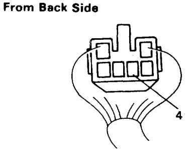

https://images.2carpros.com/forum/automotive_pictures/248015_6_8.jpg
https://images.2carpros.com/forum/automotive_pictures/248015_7_10.jpg

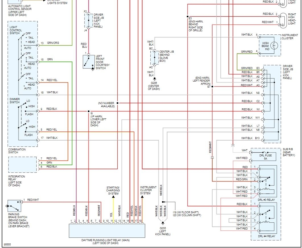

Connector Connected Connect the wire harness side connector to the sensor and inspect wire harness side connector from the back side. as shown. If the circuit is as specified, try replacing the sensor with new one. If the circuit is not as specified, inspect the circuit connected to other parts. Read this guide on using a test light, it will help you do this https://www.2carpros.com/articles/how-to-use-a-test-light-circuit-tester See the wiring diagrams attached below

1996 Avalon: When I leave the switch on AUTO the lights stay on after engine shut off but they go off when I open the driver door. There may be a relay that is not functioning. Search a wiring diagram for such a relay and switch for one from junkyard.
