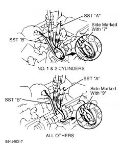

My car makes a tapping noise when I accelerate. I was told it was my engine lifters. What could be done to repair this?
Oct 30, 2010 at 8:06 AM
MMPRINCE4000
  • 8,548 POSTS
Toyota's use a shim to adjust valves, it only requires removing the valve cover, but requires a special tool set.
