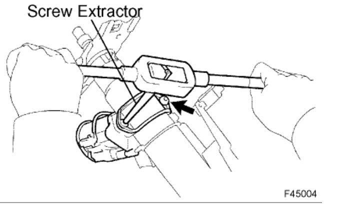

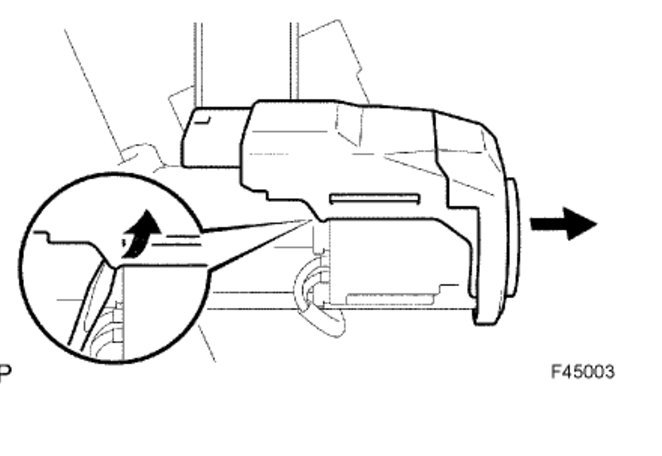

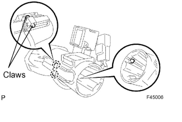

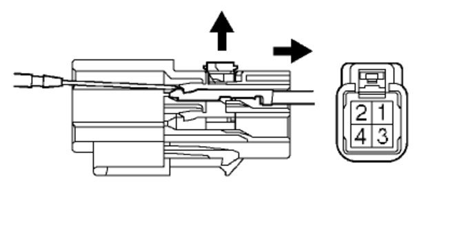

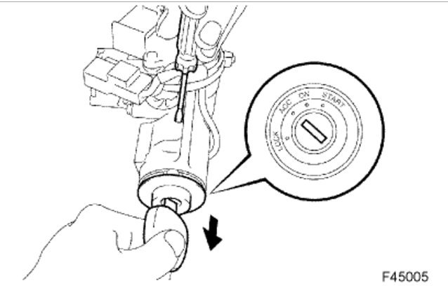

Here are procedures for removing the ignitionlock assy. If equipped with SRS, extra care must be taken while removing ang installing to avoid damage to the SRS cable reel.
IGNITION SWITCH & LOCK CYLINDER
Removal

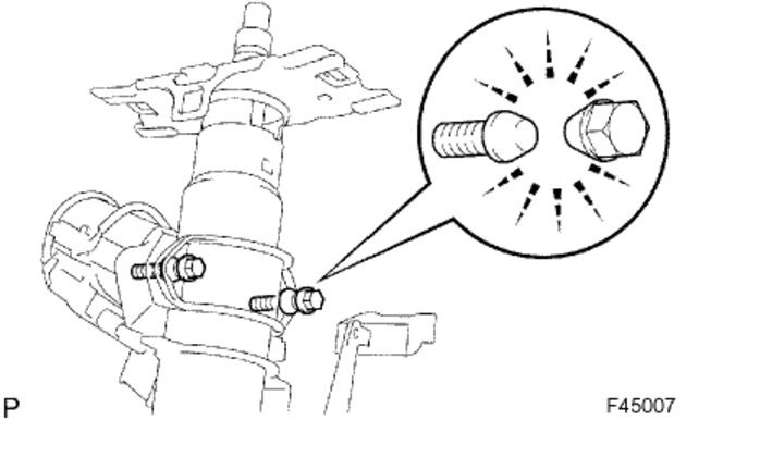

1. Remove steering wheel and combination switch (if necessary). Disconnect ignition switch harness connectors. If shear bolt studs are accessible, use a hacksaw to cut slots into exposed studs.
2. Remove studs using a screwdriver. If shear bolt studs are recessed or hard to reach with hacksaw, use a center punch on studs. Using a drill bit and screw extractor, remove studs. Place key in ACC position and remove ignition switch and lock cylinder.
Installation
To install, reverse removal procedure. Install NEW shear bolts. Tighten shear bolts finger tight. Ensure proper operation of ignition switch and lock cylinder. Tighten shear bolts until heads break off. Install combination switch, upper and lower steering column covers and steering wheel (if removed). Tighten steering wheel nut and Torx screws to specification.
