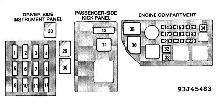

Hello - Thanks for the info. There must be something wrong with the code scanner........codes should come up. That way we can verify the codes specific to you vehicle. I have attached a pic of your fuse panel. Please use an ohm meter to check the fuses since they are hard to see sometimes if blown. Check fuses, 7, 31, 32 and 33.
https://images.2carpros.com/forum/automotive_pictures/248015_F1_7.jpg
If they are all good then do the below. Since we don't have the specific codes, turn on the AC to verify which wire is the hot wire. It looks like the blue wire is the hot on the one fan but not sure on the other. When you figure that out, connect from the battery, positive to one side of the motor and ground the other. Does the fan turn? If not the fan motor is bad. The VSS - I show a Red/Blu wire, Pink, and Light Green wire coming out of the VSS on top of the transaxle. Look for these wires to connect to.
