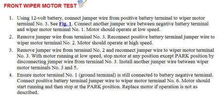

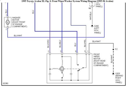

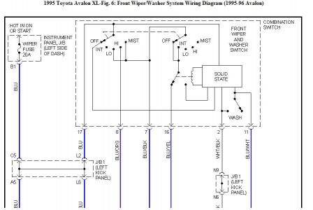

I am having a problem with the wiper motor switch located on the right hand side of the steering wheel. The intermit. speed doesn't work. The med. and high speeds are ok, but I tried everything to get the intermit. speed to work, it just goes to a med speed, and it never shuts off in the right position. It's always in the middle of the windshield or midway. Is it the motor or the switch, or what???????

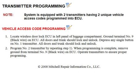

Also, the alarm remote control isn't working. I've narrowed it down to the remote, the car alarm does turn itself on when you use the key to lock it up. I put new batteries in the Fob and it still doesn't work, could this be the remote control (fob).

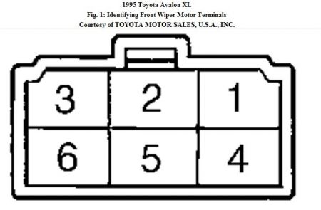

Hi Douglas , Thank you for the donation. Test the wiper to see if the parking speed is working.
https://images.2carpros.com/forum/automotive_pictures/192750_WiperTestFrt95Avalon_1.jpg
https://images.2carpros.com/forum/automotive_pictures/192750_WiperTestFrt95Avalon01_1.jpg
https://images.2carpros.com/forum/automotive_pictures/192750_WiperWiring95Avalon01_1.jpg
https://images.2carpros.com/forum/automotive_pictures/192750_WiperWiring95Avalon02_1.jpg
The alarm system is most likely to be a fault with the fob. Try reprogramming the fob.
https://images.2carpros.com/forum/automotive_pictures/192750_FOBProgramming95Avalon_1.jpg
