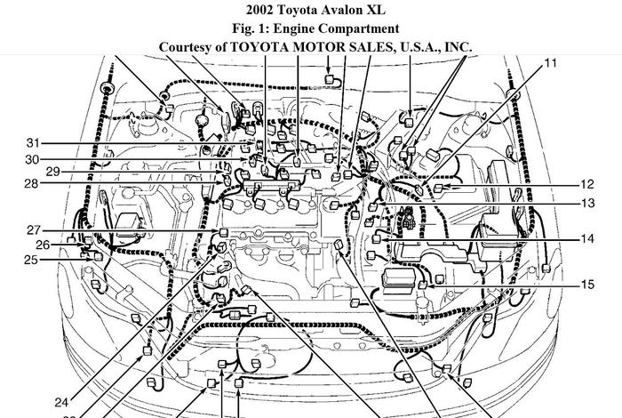

Twice in the last few months, when my car is cold, I start the engine and it will not idle. I keep trying to start the engine. I finally hold the accelerator down at about 1500 rpms for a few seconds and the car does fine. The car will start and no further problems have occurred. I did limited research online. Comments posted indicate the problem may be the coolant sensor (ECT). I thought I would change the sensor, however, I need a diagram or some instructions on first how to locate the ECT and the how to replace it. Thank you in advance for your help.
Jun 29, 2019 at 4:18 PM (Merged)
KHLOW2008
  • 41,814 POSTS
This looks more like a fault with the IAC rather than the ECT. Try cleaning the IAC and throttle body first.
ECT is located on water outlet, top right front of engine, item # 29.
