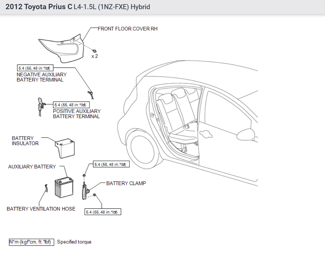

I have a 2012 Toyota Aqua, previously it was working well and able to went into electrical. As I am talking is always engine only and pops up check engine regenerative brake, traction and vehicle with Exclamation mark on center . When scanned with a Creader OBD it shows the following codes: So here are the codes: u0073, u0124 and c1259. Please team this has really confused me. help please if one has an idea.

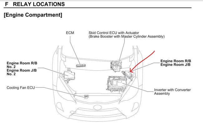

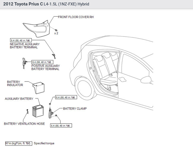

The first thing I would do is turn the system on and ten check all fuses here is a guide to help and the fuse location in the images below. Also is the 12-volt battery in good condition. I would turn the car off and test for 12 volts at the battery.
Here is a guide to help with that as well:
and
There should be about 12.4 volts at the battery. Please check the images below and get back to me.
