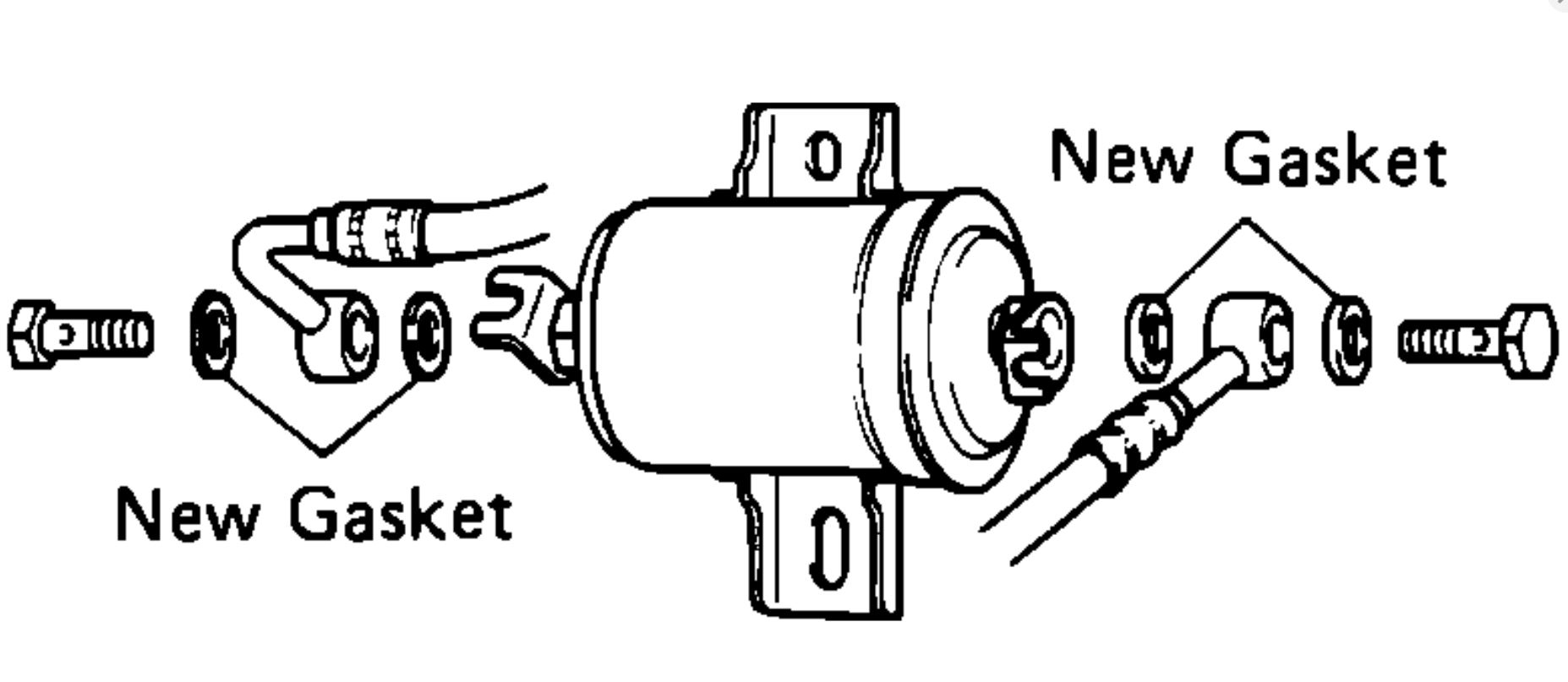

Where is the fuel filter located on a 1991 Toyota 4Runner SR5 4x4 2.4L 4 cylinder?
Apr 23, 2007 at 9:06 PM
  • 75,992 POSTS
The Fuel Filter is Located at the right side of the engine above the starter motor.
NOTE: If vehicle has been operated within an hour, the fuel system is probably under pressure and requires caution when removing filter union bolts.
REMOVAL:
1. Locate the fuel filter on the right side of the engine.
2. Slowly loosen the filter union bolts. Some gasoline may escape, so ensure that the potential for fire is minimized.
3. Remove the union bolts and four gaskets.
4. Loosen filter clamp and slip filter from clamp.
INSTALLATION:
1. Slip new filter into clamp. Ensure that flow arrows are in the correct direction.
2. Position filter in the middle of the clamp and tighten filter clamp.
Replacing The Fuel Filter
3. Reinstall both union bolts with four new gaskets.
4. Torque union bolts to 18 Nm (13 ft lbs). DO NOT overtighten union bolts.
5. Clean any gasoline that may have escaped.
6. Start the engine and check for fuel leaks.

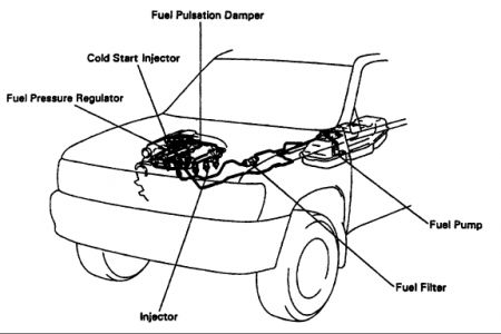

1995 Toyota 4Runner 6 cyl Four Wheel Drive Automatic
Does my 4Runner have a fuel filter. If so, where is it located? Can't find the filter in auto stores.
Apr 17, 2019 at 6:35 PM (Merged)
  • 75,992 POSTS
Fuel Filter Location
https://images.2carpros.com/forum/automotive_pictures/12900_ff_29.jpg
Fuel Lines And Components
https://images.2carpros.com/forum/automotive_pictures/12900_ff1_9.gif
The Fuel Filter is located on the right frame rail underneath the passenger compartment.

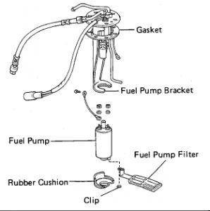

RANDY MOORE
I have been unable to find the fuel filter on my 4 runner. I saw on one of the entries for a 1985 that it is in the top of the gas tank. Is that where i need to look for mine?
  • 75,992 POSTS
1986 Toyota Truck 4 Runner 4WD L4-144.4 2366cc 2.4L SOHC (22R-E) Engine Compartment Fuel Filter
https://images.2carpros.com/forum/automotive_pictures/12900_ff_5.gif
Fuel Tank Pump and Filter
https://images.2carpros.com/forum/automotive_pictures/12900_ff1_5.jpg
