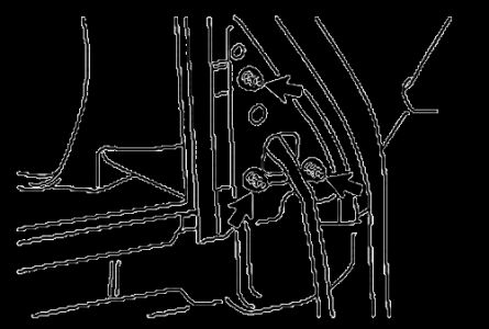

Need assistance with installation of replacement power, heated passenger side review mirror for my 2005 Toyota 4 Runner. Installation diagram would be very helpful.

2003-05 Models Remove the front door lower frame bracket garnish. Remove the front door inside handle bezel. Remove the front armrest. Remove the front door trim board. Remove the front door service hole cover. Disconnect the outside mirror electrical connector. Remove the mounting nuts and outside mirror. Fig. Outside mirror mounting nut location-2003-05 Models Installation is the reverse order of removal. Tighten the mirror mounting nuts to 71 inch lbs. (8 Nm).
https://images.2carpros.com/forum/automotive_pictures/307763_0900c152801addd3_1.jpg
