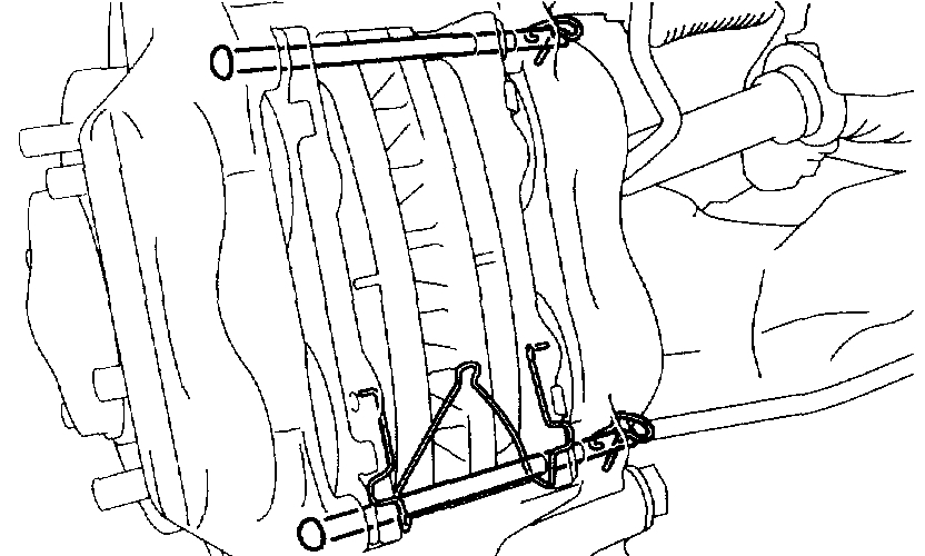

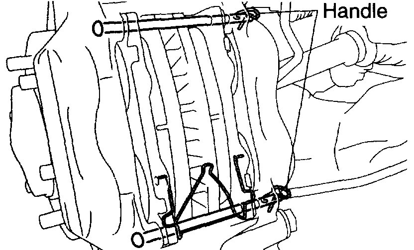

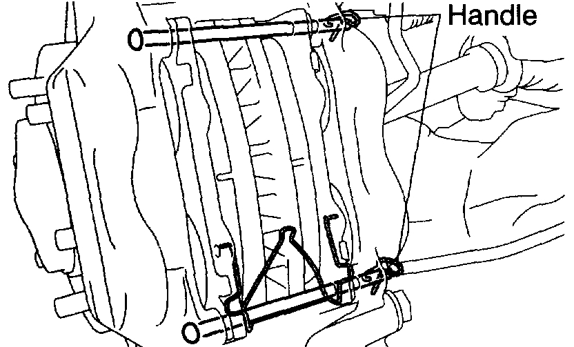

3. REMOVE FRONT DISC BRAKE ANTIRATTLE W/HOLE PIN
a. Remove the 2 pin hole clips, then remove the 2 anti-rattle w/hole pins from disc brake cylinder assy.
b. Remove the anti-rattle spring from the disc brake pad.

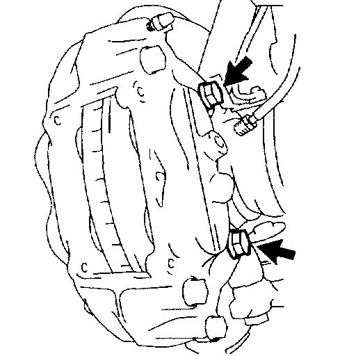

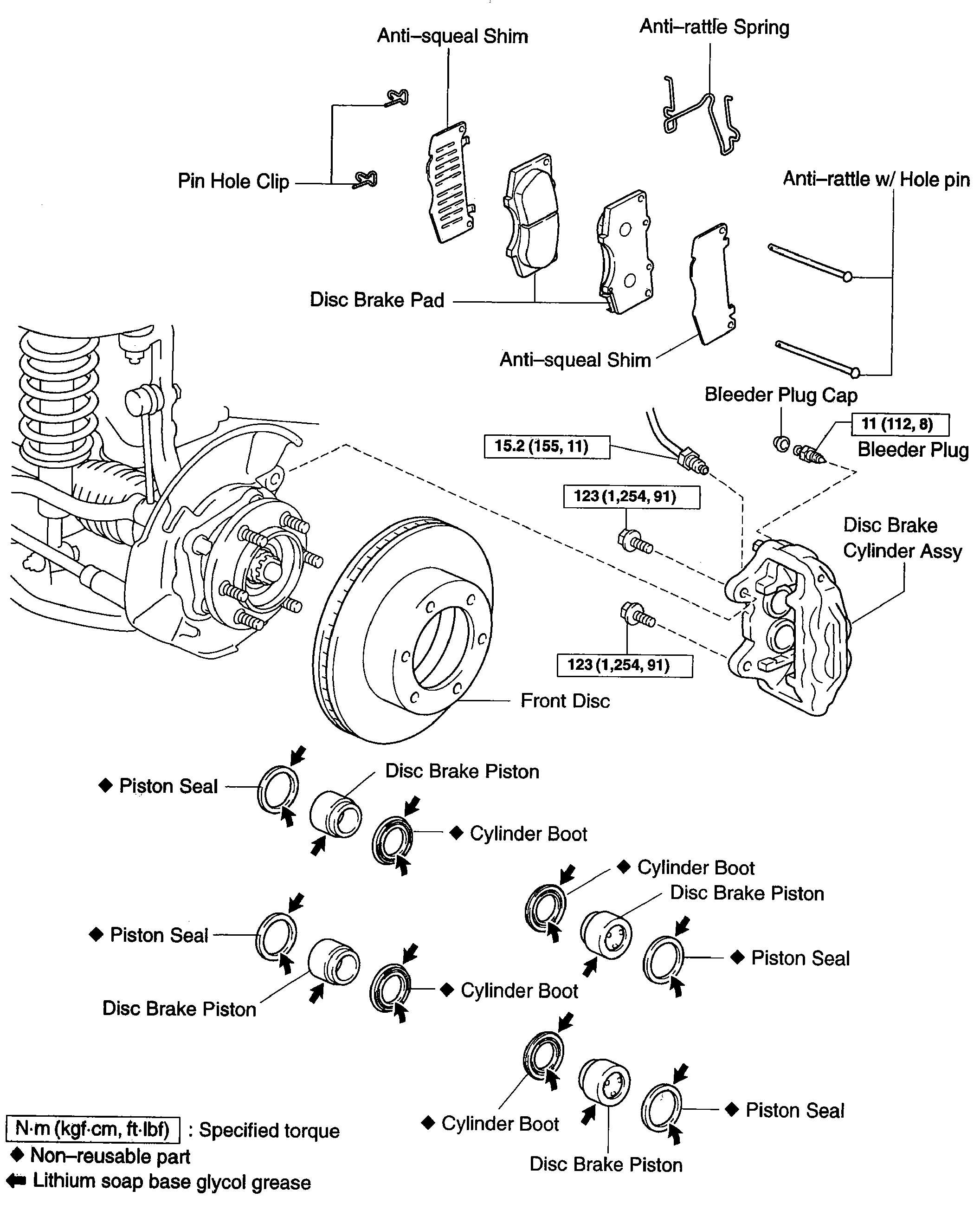

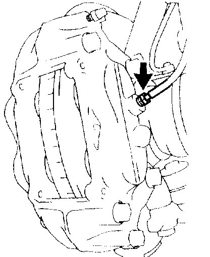

6. REMOVE DISC BRAKE CYLINDER ASSY LH
pic 3
a. Using SST, disconnect the brake tube from the disc brake cylinder assy.
SST 09023-00100
HINT: Use a container to catch brake fluid as it drains out.

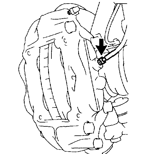

pic 4

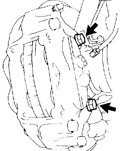

b. Remove the 2 bolts and remove the disc brake cylinder assy.
pic 5

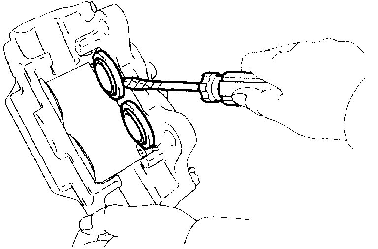

7. REMOVE CYLINDER BOOT
a. Using a screwdriver, remove the 4 cylinder boots from the caliper,

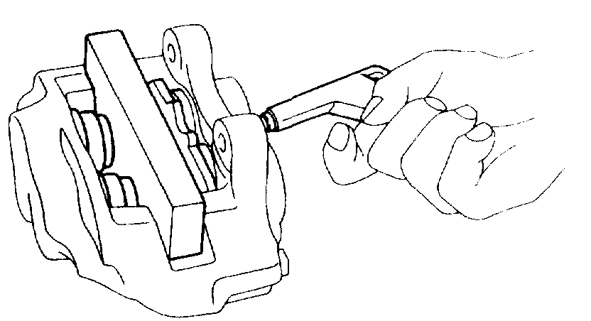

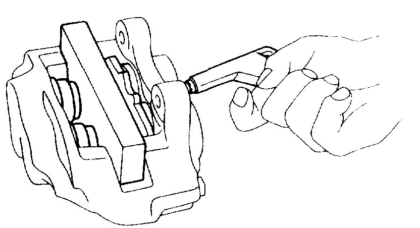

8. REMOVE FRONT DISC BRAKE PISTON
pic 6

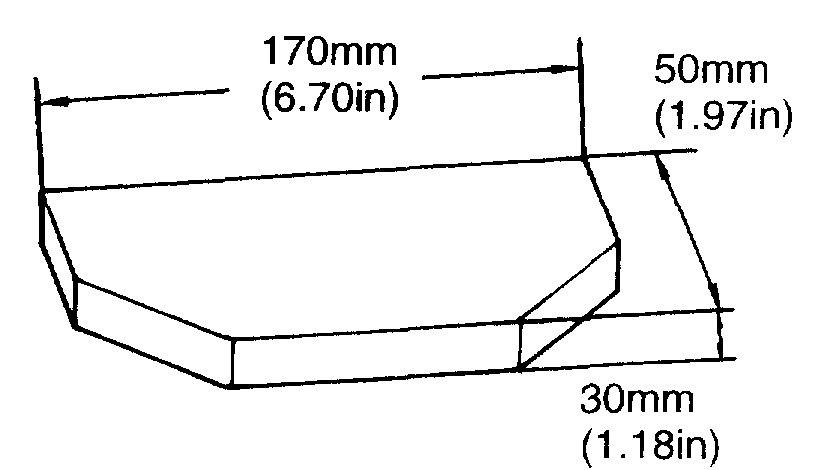

a. Prepare the wooden plate to hold the pistons.
pic 7
b. Place the plate between the pistons and insert a pad at one side.
c. Use compressed air to remove the pistons alternately from the cylinder.
CAUTION: Do not place your fingers in front of the piston when using compressed air.

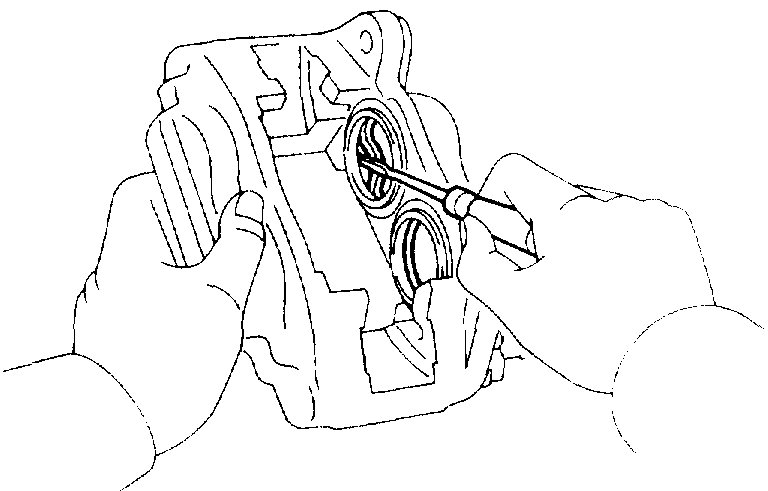

9. REMOVE PISTON SEAL
a. Using a screwdriver, remove the 4 piston seals from the cylinder.

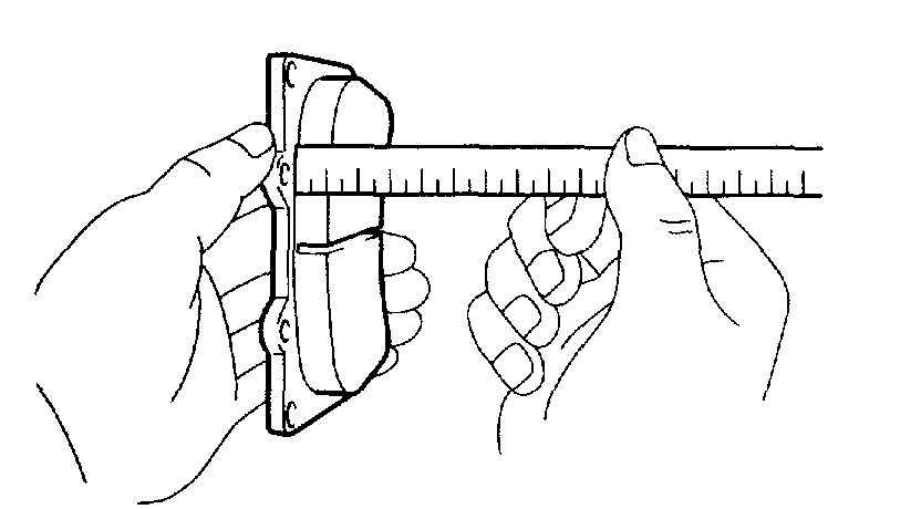

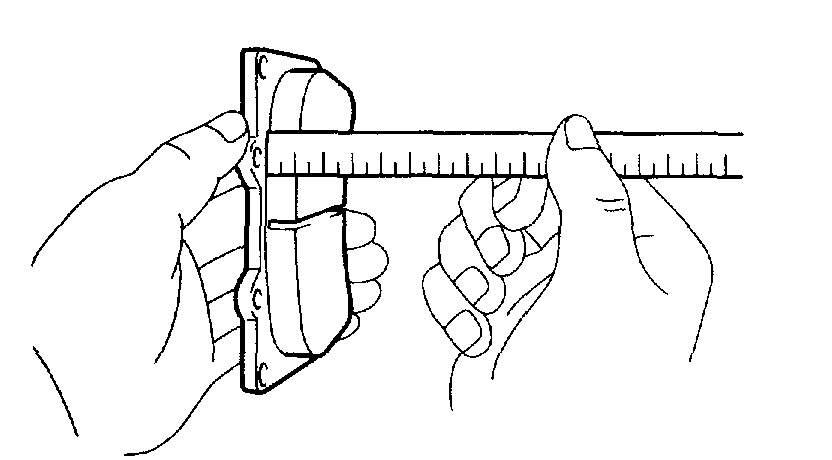

12. INSPECT PAD LINING THICKNESS
a. Using a ruler, measure the pad lining thickness.
Standard thickness: 11.5 mm (0.453 inch)
Minimum thickness: 1.0 mm (0.039 inch)

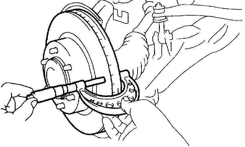

13. INSPECT DISC THICKNESS
a. Using a micrometer, measure the disc thickness.
Standard thickness: 28.0 mm (1.102 inch)
Minimum thickness: 26.0 mm (1.024 inch)

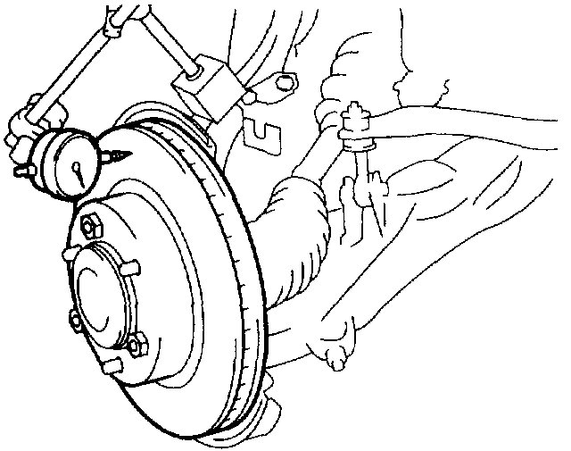

16. INSPECT DISC RUNOUT
a. Temporarily fasten the disc with hub nuts.
Torque: 110 Nm (1,122 kgf-cm, 81 ft. lbs.)
b. Using a dial indicator, measure the disc runout 10 mm (0.39 inch) away from the outer edge of the disc.
Maximum disc runout: 0.05 mm (0.0020 inch)
c. If the disc runout is maximum value or greater, check the bearing play in the axial direction and check the axle hub runout. If the bearing play and axle hub runout are normal, adjust the disc runout or grind it on a "On car" brake lathe.

21. INSTALL DISC BRAKE CYLINDER ASSY LH
pic 12
a. Install the disc brake cylinder assy with 2 bolts.
Torque: 123 Nm (1,254 kgf-cm, 91 ft. lbs.)
pic 13
b. Using SST, connect the brake tube to the disc brake cylinder assy.
SST 09023-00100
Torque: 15.2 Nm (155 kgf-cm, 11 ft. lbs.)

24. INSTALL FRONT DISC BRAKE ANTIRATTLE W/HOLE PIN
a. Install the 2 anti-rattle w/hole pins and anti-rattle spring to the disc brake cylinder.
HINT: Anti-rattle spring is installed with bottom side of anti-rattle w/hole pin.
b. Install the 2 new pin hole clips to the anti-rattle w/hole pin.
NOTICE: When installing the pin hole clip, be sure to install the pin hole clip with the handle facing to the vehicle center.
