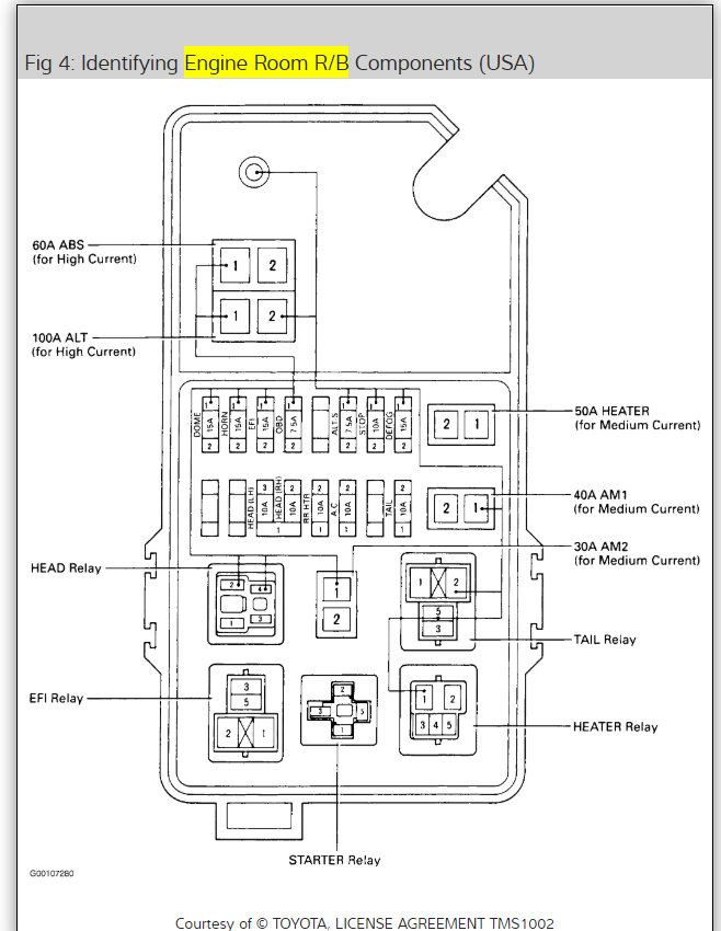

The windows and horn do not work. Tried to replace fuse but cant find it. Help! If it is the fuse "box", is this something I can do myself or does a mechanic need to replace?
Apr 30, 2009 at 5:52 PM
NOMADELMUNDO
  • 6 POSTS

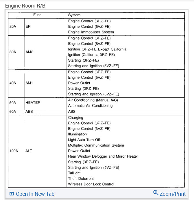

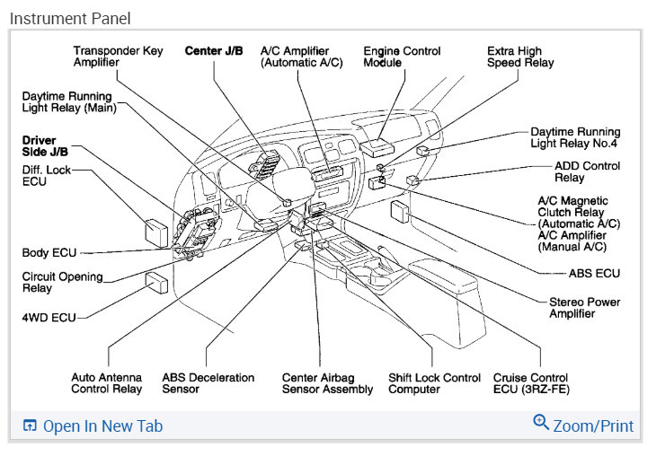

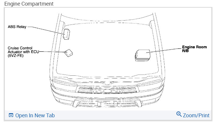

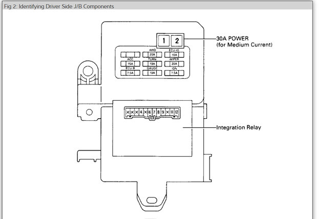

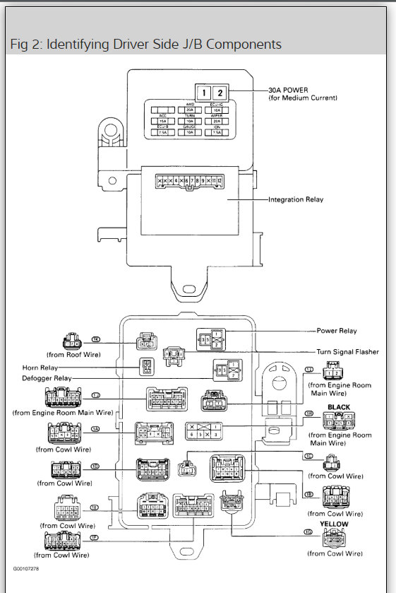

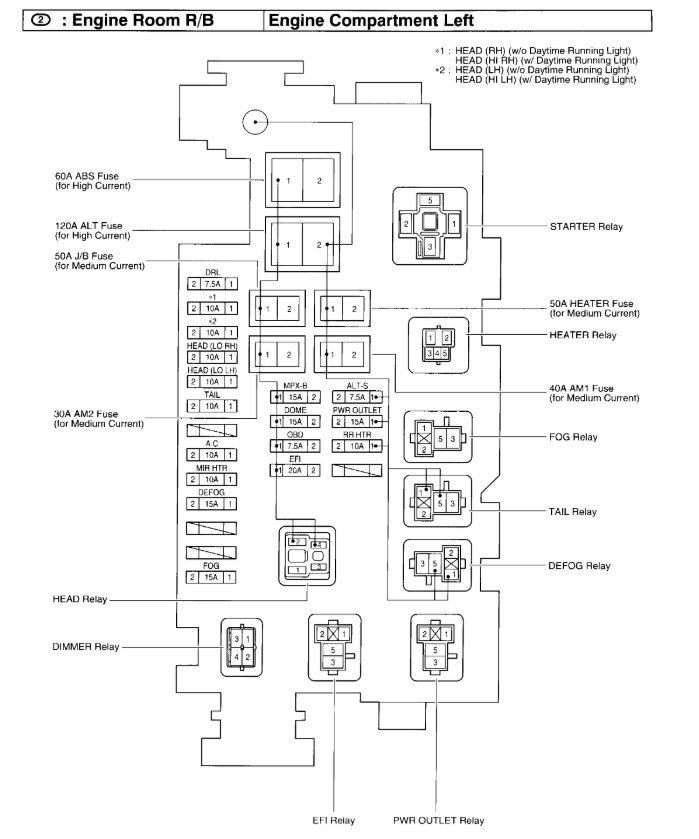

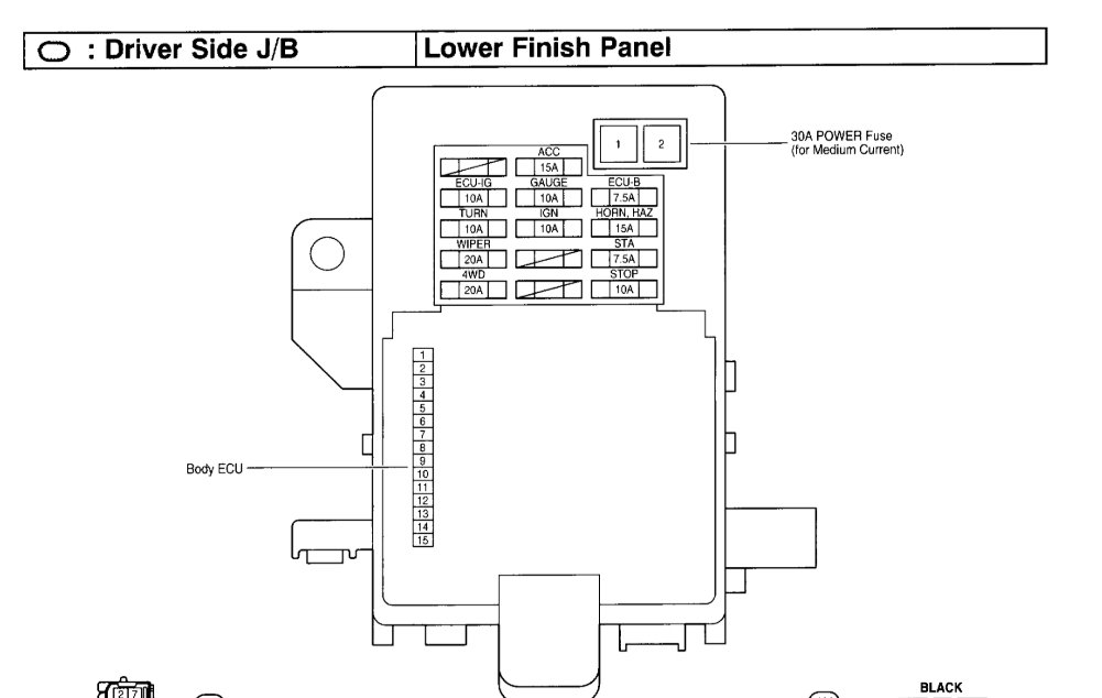

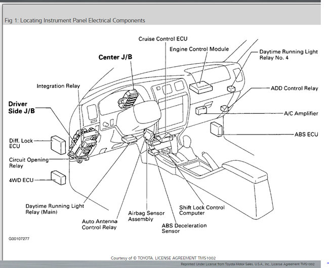

Hopefully it's a fuse problem. It should be one of the smaller ones under neath the hood but most likely on left lower side of your steering wheel.
Just take each of those out with a long nose pliers and see which one is burnt out and replace it with a fuse that will run you few dollars from a auto supply store.

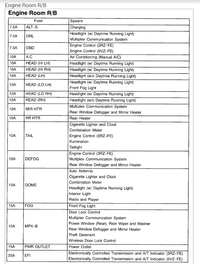

I have attached to 2 photos for reference. The horn fuse is the 7.5amp one on the top right corner on the driver side. Hopes this helps.

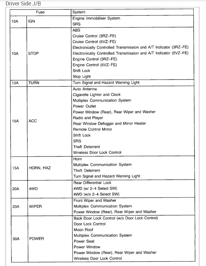

The fuse is located in the fuse box. Here are some diagrams (below) that will help you find the fuse box and a guide to help you test them. The fuse you want to test is the 15 amp ACC #20 (accessory fuse).
