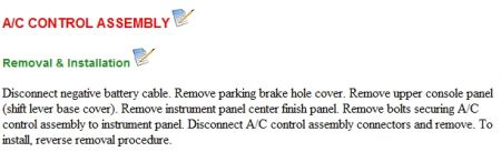

I have a problem with my A/C in a 2000 4Runner Ltd. Long story short, I think the A/C dash switch has gone out (I say this because if I hit the defrost button, it will activate the A/C button and blow cooled air, but I can not activate the A/C itself).
My questions are
1) Is it reasonbly simple to remove this faceplate from the front? If so....
2) Is there any reason why I couldn't replace and "remount" this faceplate myself?
Thanks!

Do you have auto A/C or manual A/C equipped

It has an auto button, but it has the same problem (won't activate the A/C with auto set to on or off).
For that matter, the auto button will not light up either.

steps below are to remove the a/c control panel
https://images.2carpros.com/forum/automotive_pictures/261618_Noname_2152.jpg

Awesome, thanks!
