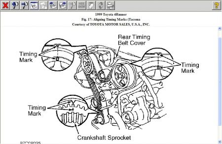

If you lose your timing marks while replacing the belt , how do you get them back? Do you set the crank pulley mark at a specified degrees on the indicator (atdc or btdc) and does the overhead cam pulley marks go straight up? This is for a 1999 4 Runner, 6 cyl, Thanks

Put the engine no.1 piston on its comrpession stroke/TDC and then line everything up see below
https://images.2carpros.com/forum/automotive_pictures/12900_timing_15.jpg
