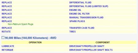

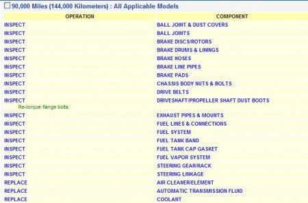

1999 Toyota 4Runner 90,000 Mile Service?
1999 TOYOTA 4RUNNER
91,000 MILES • 6 CYL • 4WD • AUTOMATIC
JBENINK
Can you please tell me what services need to be performed for the 90,000 mile scheduled maintainence? I bought this 4Runner used and it runs great - I just don't want to get ripped off on repairs that aren't needed.
Thanks.

https://images.2carpros.com/forum/automotive_pictures/261618_Noname_969.jpg
https://images.2carpros.com/forum/automotive_pictures/261618_Noname2_269.jpg
