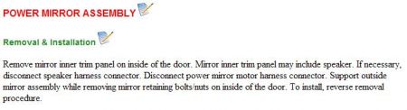

What do I need to remove in order to replace the passenger side mirror

Hello and thanks for donating!
Below are the proper steps to replacing your vehicle's side mirror assembly...
