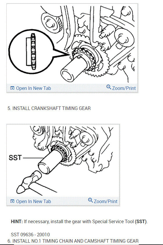

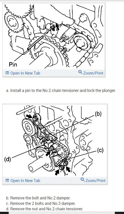

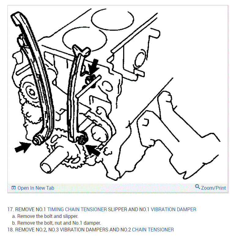

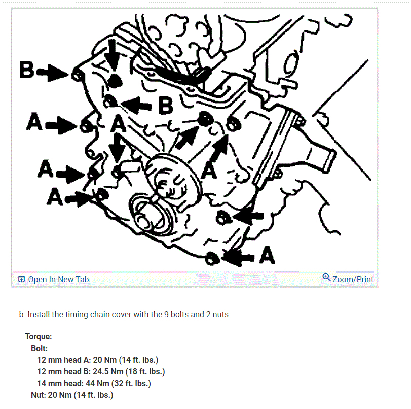

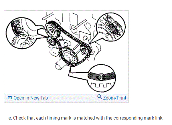

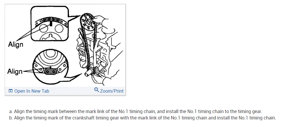

Where are the timing marks for this engine?
Apr 30, 2008 at 8:05 PM
  • 110,248 POSTS

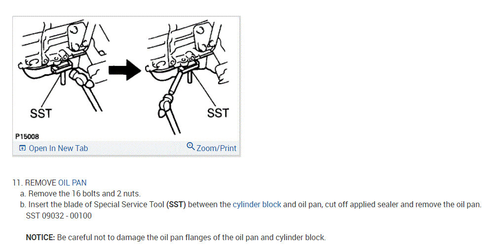

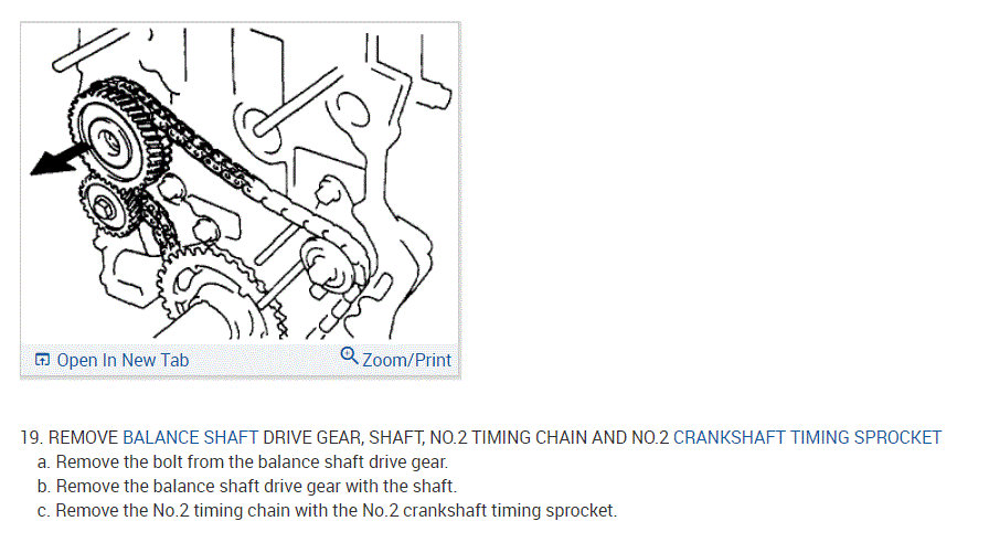

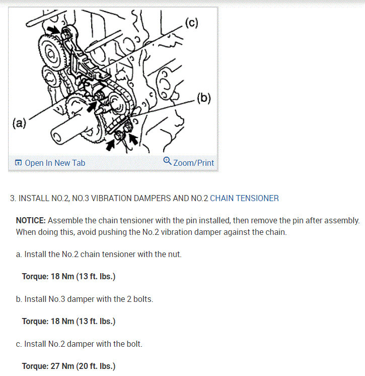

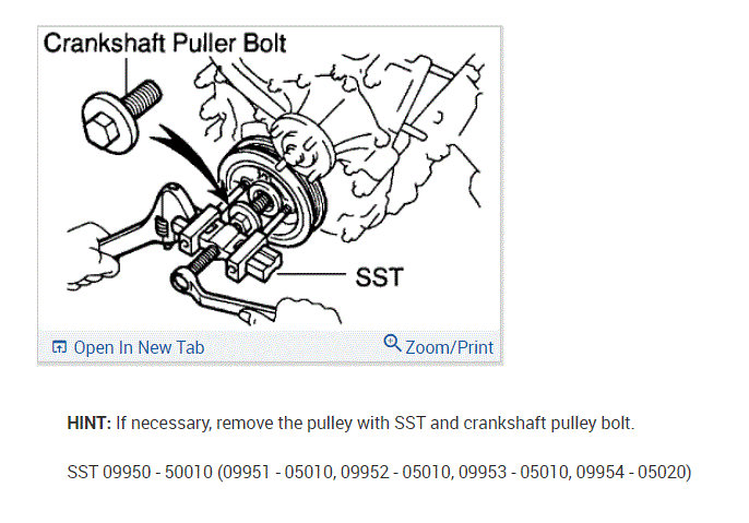

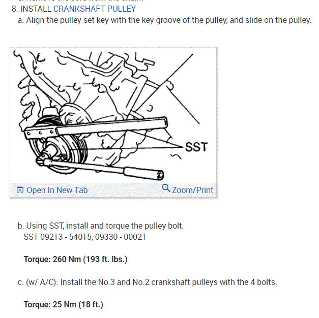

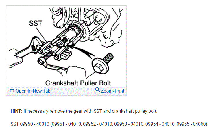

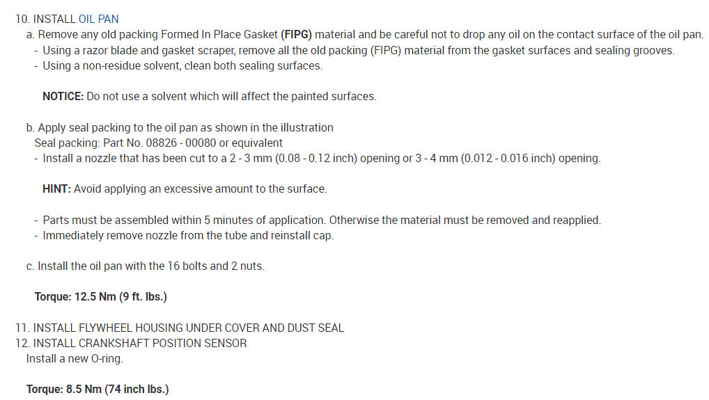

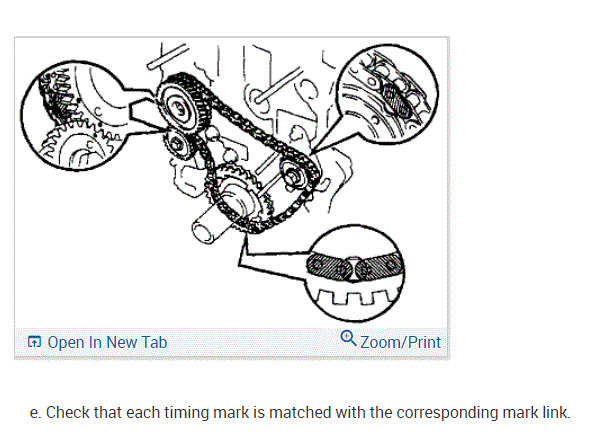

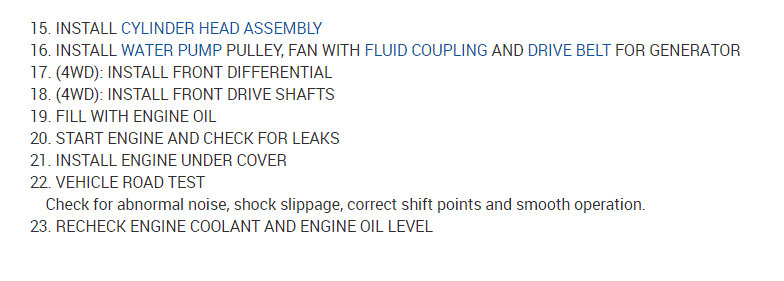

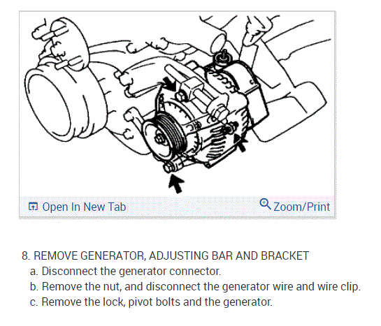

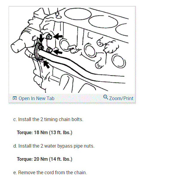

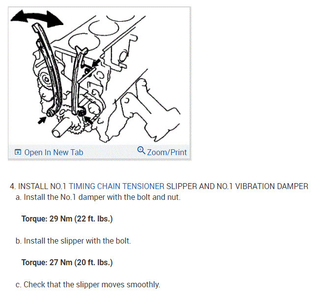

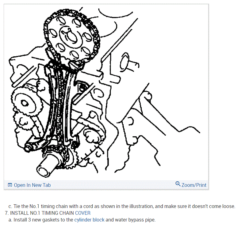

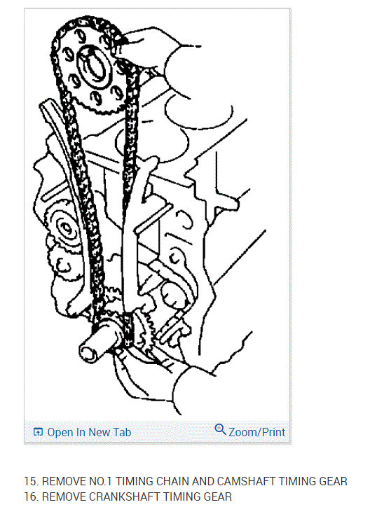

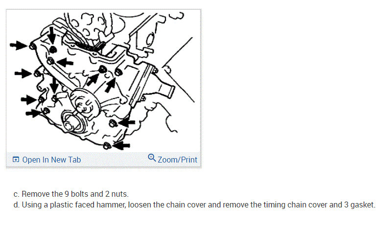

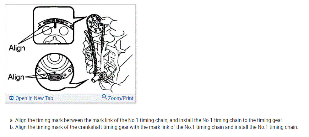

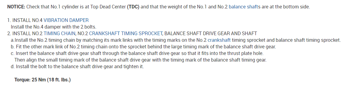

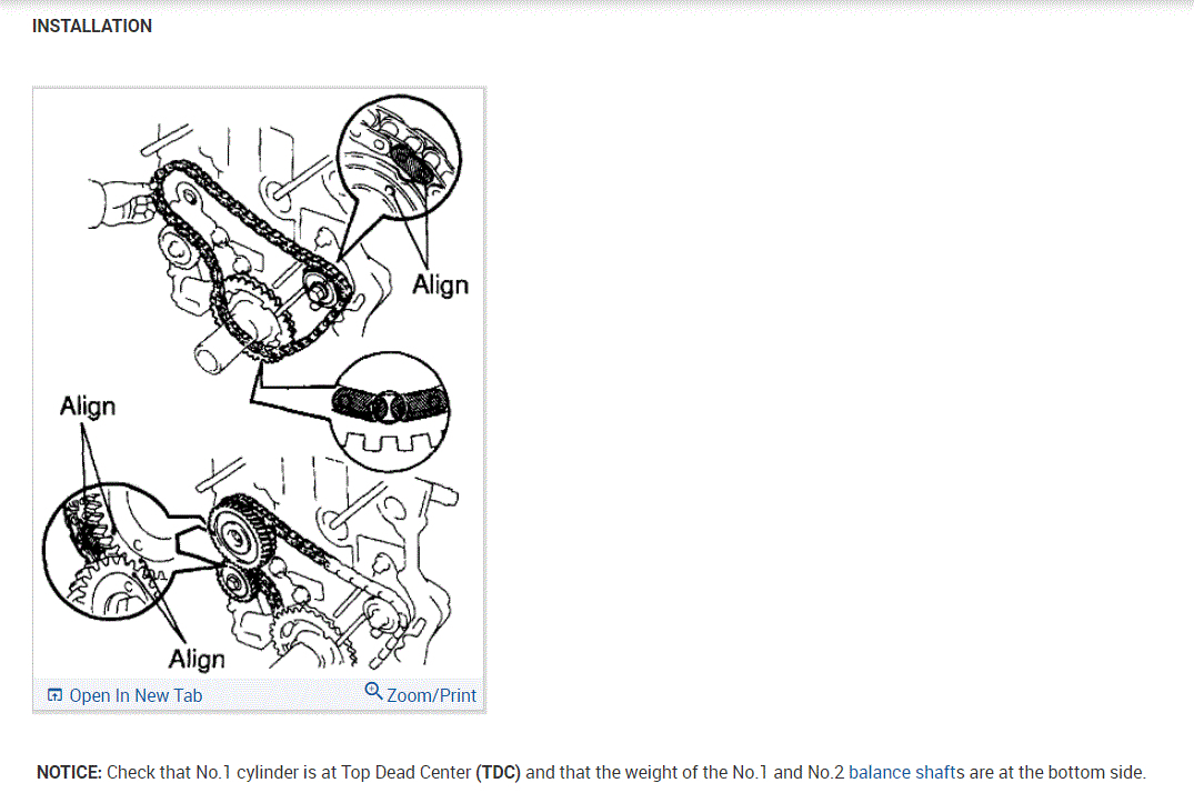

When setting the engine timing, there are marks on the timing chain gears that align with colored links on the timing chain.
This is a big job, so take your time.

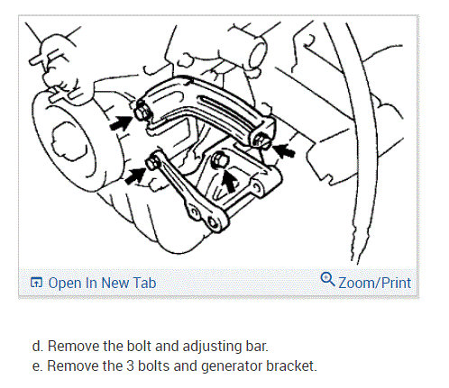

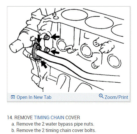

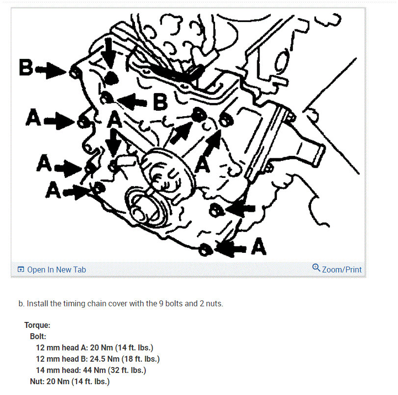

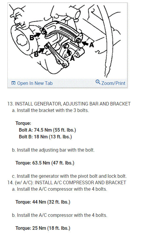

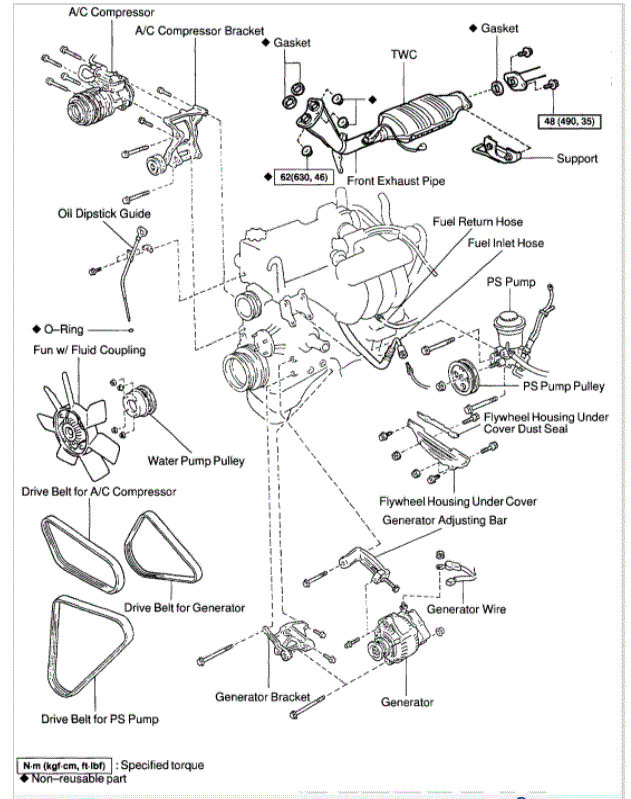

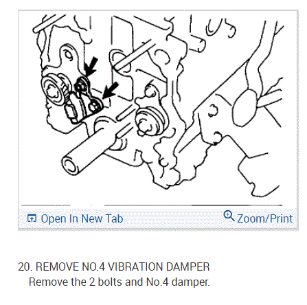

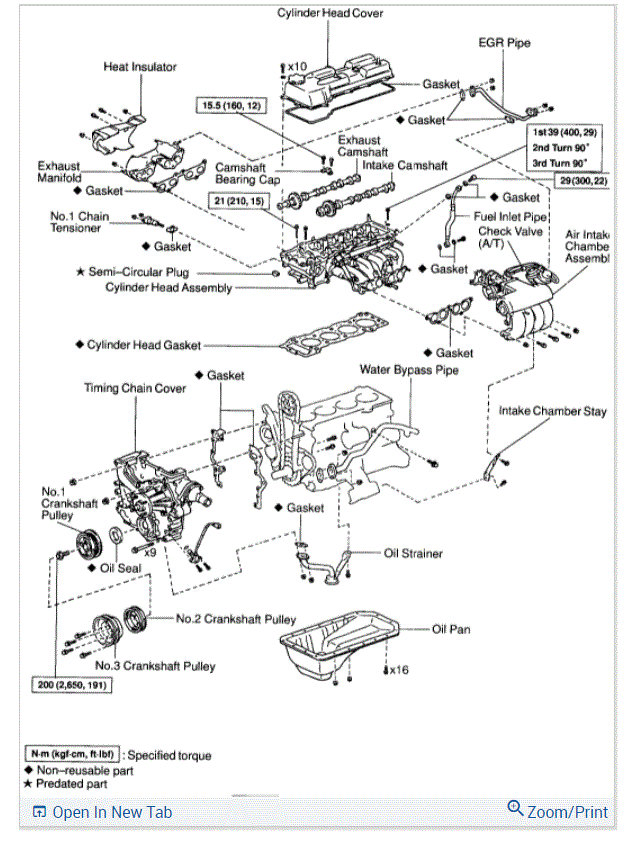

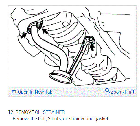

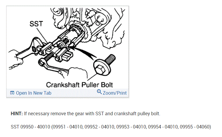

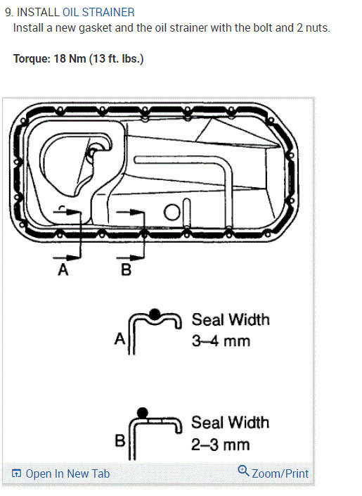

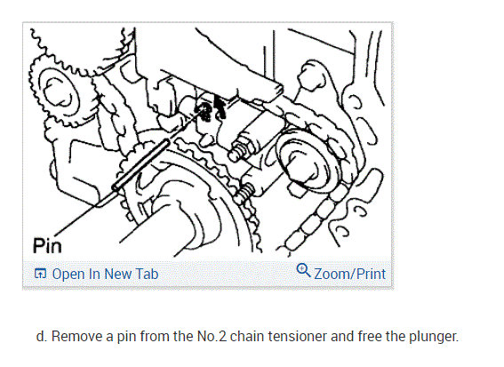

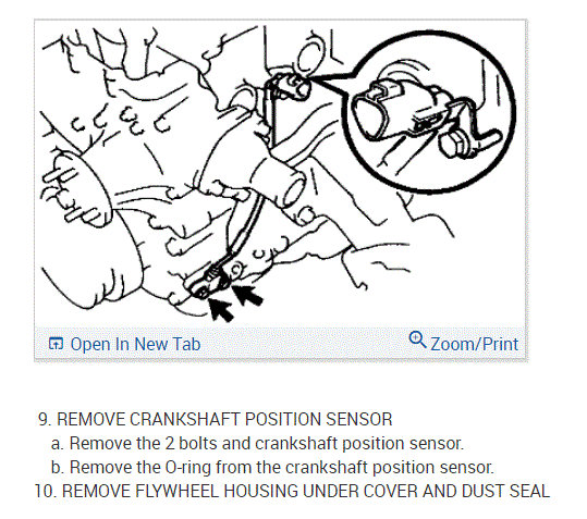

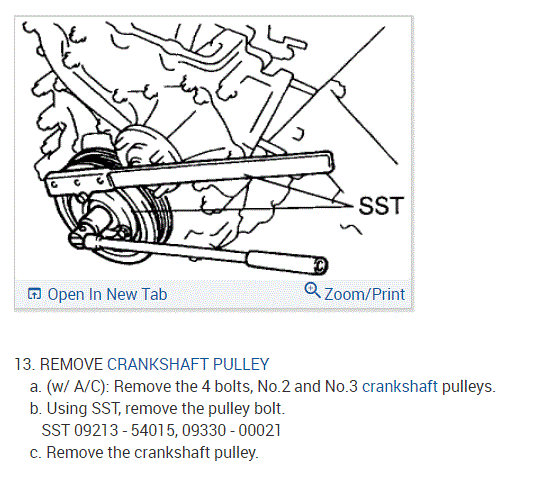

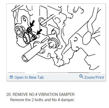

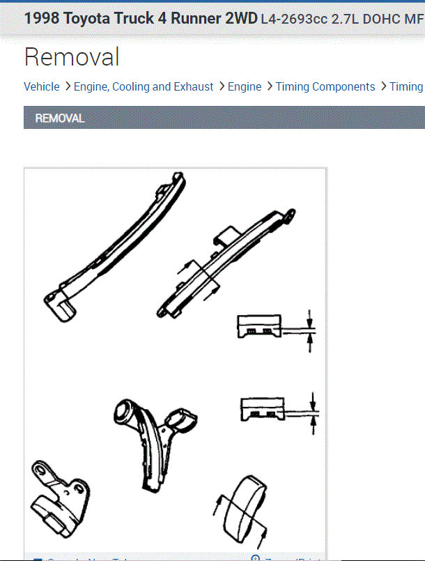

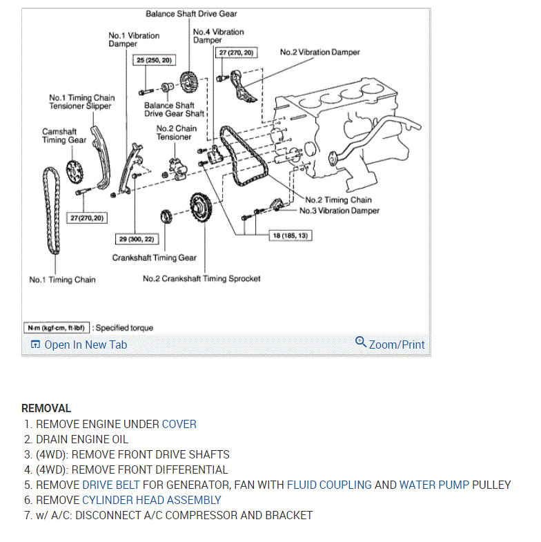

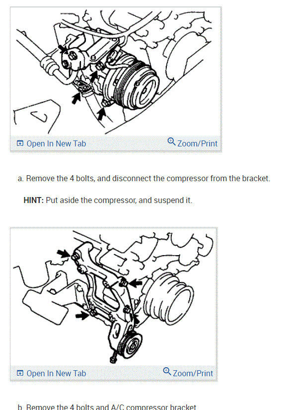

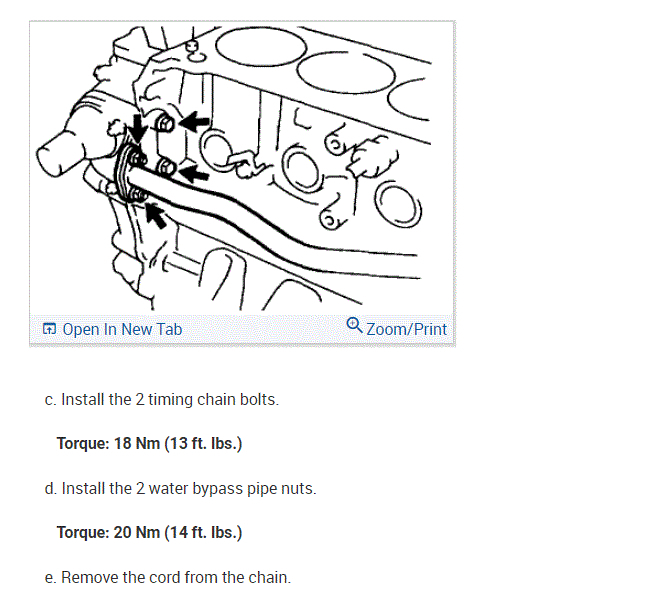

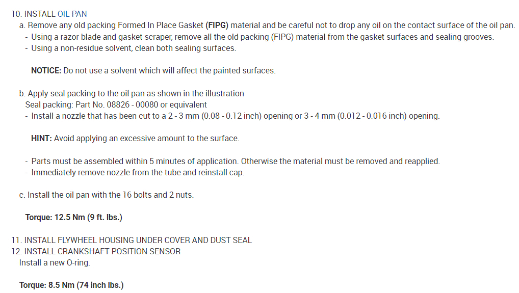

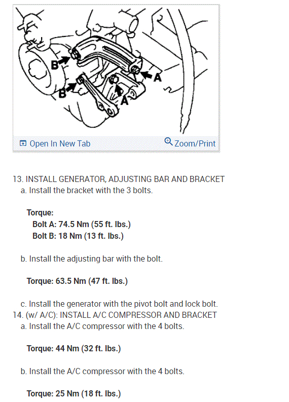

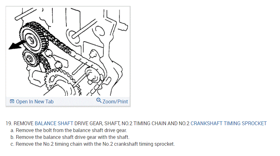

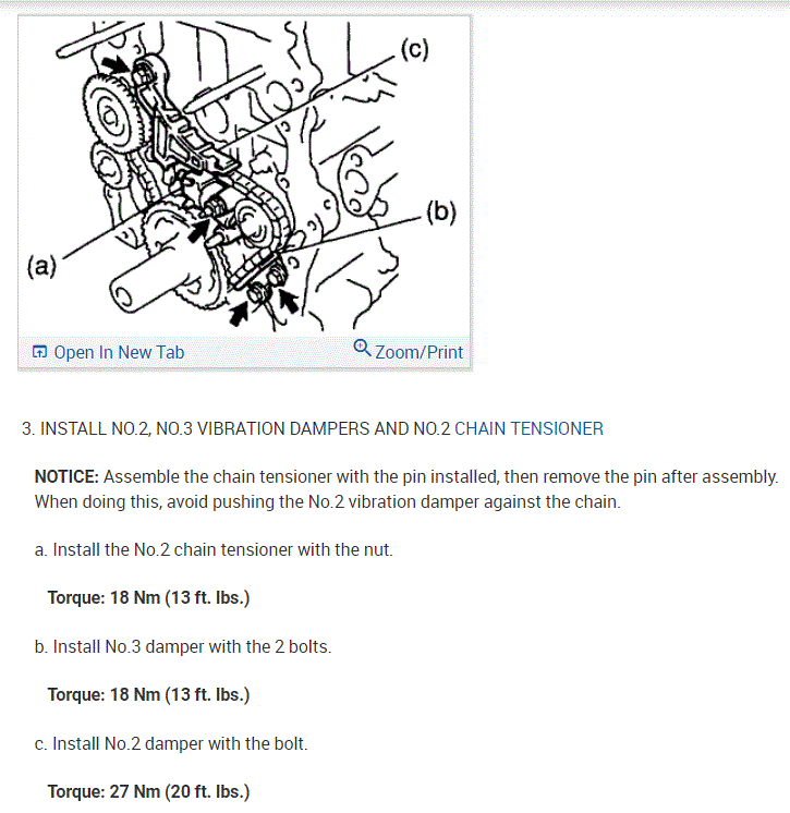

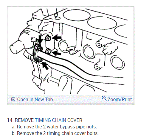

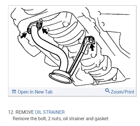

I attached the directions for removal and replacement of the timing chain below. These directions are specific to this vehicle and provide the directions for timing.
