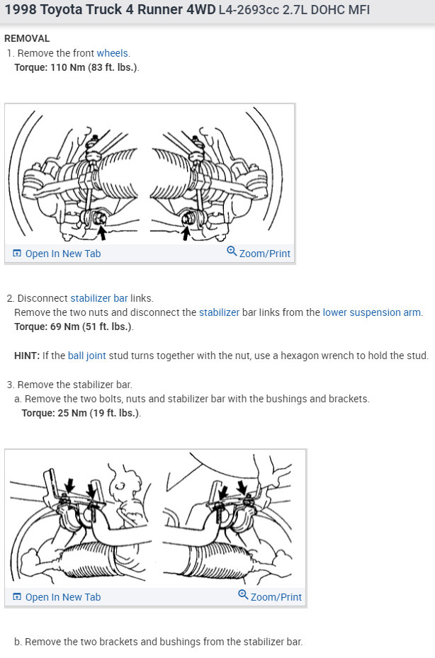

While accelerating my truck pulls to the right. When letting up on the accelerator it sways back to the left. It also sways back and forth continuously while driving. Not sure if this is related but figured I'd divulge it.
Mar 16, 2009 at 2:33 PM
SQM
  • 6,383 POSTS
It sounds like you have worn or broken suspension component(s). Which is triggering this issue.

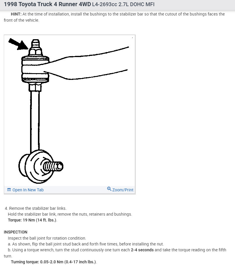

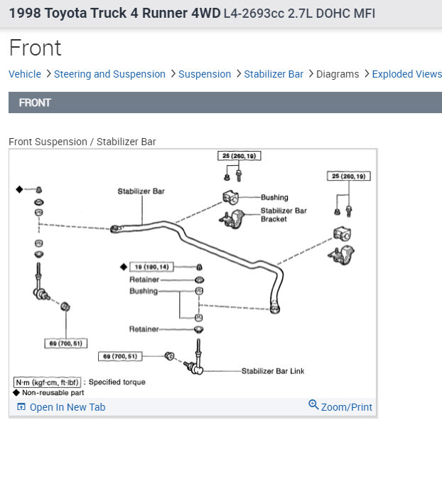

It could be due to broken sway bar link(s).
Do an inspection of the suspension. Look for any damaged components. You can also use a pry bar to check for excessive movement on any of the bushings.
https://www.2carpros.com/articles/popping-noise
