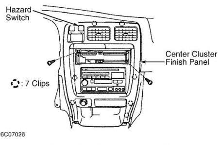

how to remove clock from dash

Removal & Installation clock is mounted to right of instrument cluster in instrument cluster center finish panel. Remove A/C switch, heater control knob and heater control panel. Remove 2 center cluster finish panel retaining screws. See Fig. 4 .
https://images.2carpros.com/forum/automotive_pictures/266999_clo_1.jpg
Using flat-blade screwdriver, carefully pry panel loose from 7 retaining clips. Disconnect wiring harness connectors. Disconnect A/C control cable. After center cluster finish panel has been removed, remove clock from panel. To install, reverse removal procedure.
