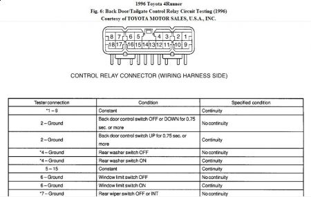

1996 Toyota 4Runner 6 cyl Four Wheel Drive Automatic 177K miles
My rear window will ony go down with concsole switch. I replaced the switch after testing it but guess I was wrong. I put it back up using battery charger on the motor leads. any ideas where to look next
Aug 10, 2009 at 1:33 PM
KHLOW2008
  • 41,814 POSTS

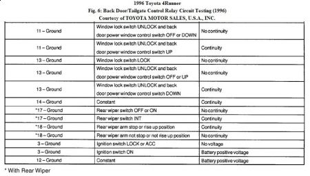

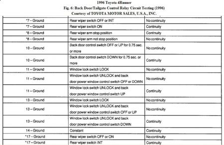

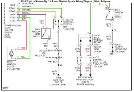

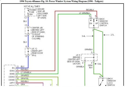

Hi NW4runner, I would suggest testing the backdoor control relay. Here are the testing procedures.
https://images.2carpros.com/forum/automotive_pictures/192750_BackDoorRelay96RunnerFig06a1_1.jpg
https://images.2carpros.com/forum/automotive_pictures/192750_BackDoorRelay96RunnerFig06b1_1.jpg
https://images.2carpros.com/forum/automotive_pictures/192750_BackDoorRelay96RunnerFig06c1_1.jpg
https://images.2carpros.com/forum/automotive_pictures/192750_BackDoorWiring96Runner01a_1.jpg
https://images.2carpros.com/forum/automotive_pictures/192750_BackDoorWiring96Runner01b_1.jpg
Aug 14, 2009 at 5:29 AM
NW4RUNNER
Hey thanks for the diagram. But I found a broken red/blk wire where it exits car and heads into tailgate. A little extension and solder took care of it
