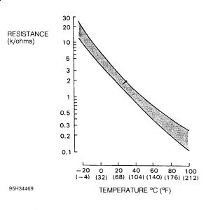

Check and test the coolant temperature sensor and also the cold start injector
Mar 3, 2010 at 4:17 AM
DOCFIXIT
  • 18,828 POSTS
Yes temp could be contributing ohm check Engine Coolant Temp sensor top rear of engine. see chart
https://images.2carpros.com/forum/automotive_pictures/198357_Graphic_371.jpg
ECT has Brown/Black and Green/Yellow wires

I DONT HAVE A CHECK ENGINE LIGHT ON. BUT I GUESS BASED UPON THE AGE THAT SENSOR COULD POSSIBLY BE BAD.WILL CHECK RESISTANCE
