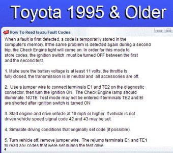

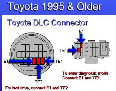

Read the codes and post the results.
https://www.2carpros.com/forum/automotive_pictures/62217_95AndOlder2_6.jpg
https://www.2carpros.com/forum/automotive_pictures/62217_95AndOlder3_7.jpg

The code that I pulled was 52----knock sensor/ECM.
Anything to do with tranny?
Friday, March 13th, 2009 AT 9:53 AM
MERLIN2021
  • 17,250 POSTS
Weel if the knock sensor is retarding your timing, which can be the case, it will affect shift patterns. I show 52 as just the knock sensor, make sure it's plugged in if it is, replace it.
