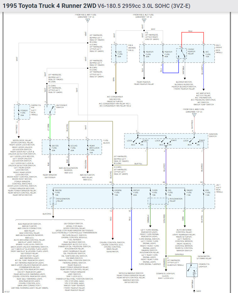

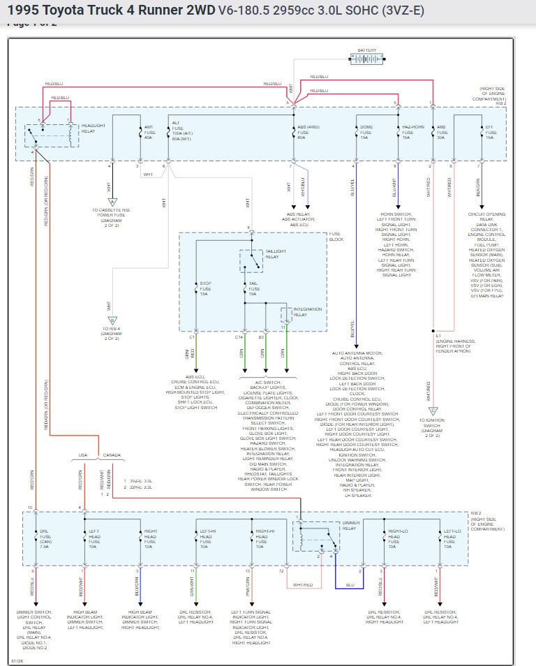

I am in process of replacing a fuse box. I took box out to take wires out and put fuse back in. There was an extra white wire with two bolts to it that I can't figure out where it goes.
Thank you. Bob
May 3, 2009 at 5:25 PM
SQM
  • 6,383 POSTS
The white wire is possibly the fusible link. It will have a spot for it in the fuse block.
The fusible link typically the main power source that goes into the block. Typically will come form the battery or alternator.

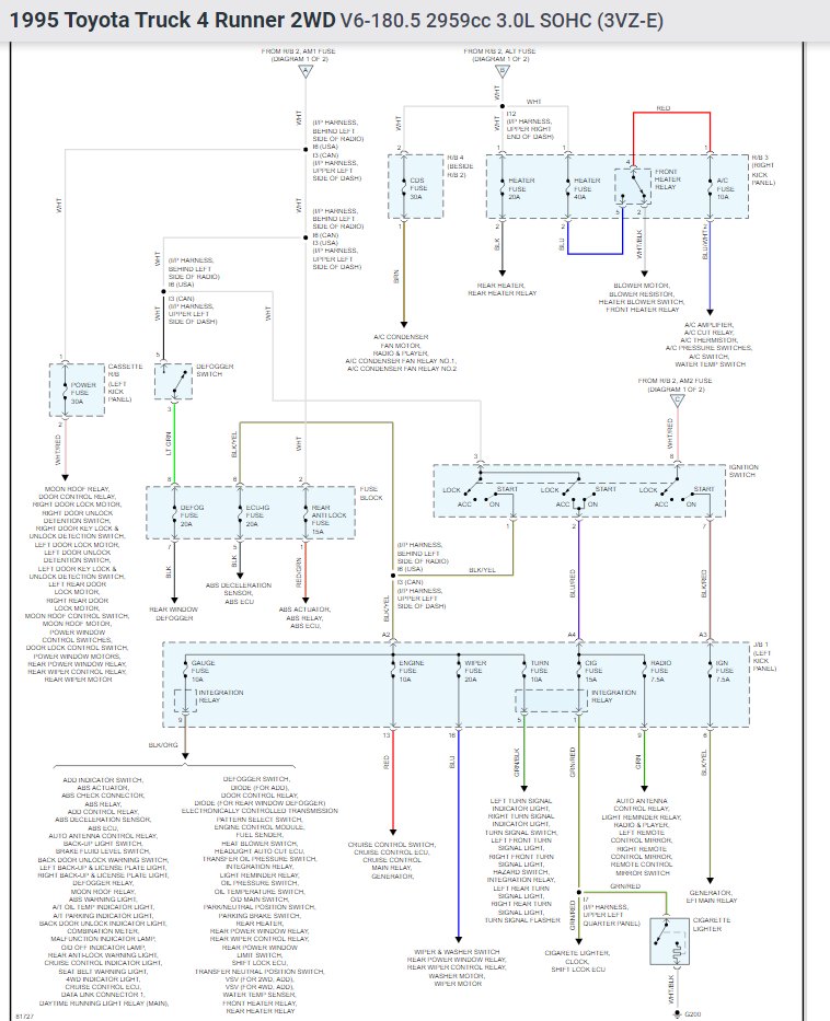

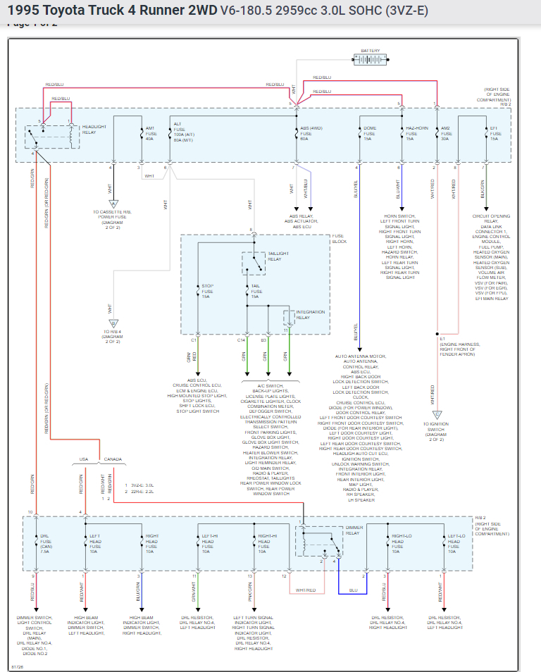

See attached for the wiring schematics for the fuse box.
