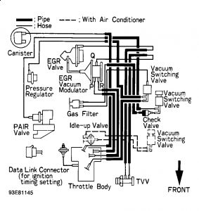

I recently bought this vehicle and after looking at the engine,I noticed that he had worked on the engine. He's a mechanic,as I am also. He told me that he had removed the valve covers and of course the intake to get to the valve covers because he wanted to replace the gaskets,,well long story short,He just took off hoses and vacuum liines left and right,and of course didnt mark anything as to were they went..So here I am trying to put it back together and well I need help..I have bought a manual for the car in question,but its not very specific as to were and how the hoses(vacuum) attach..Was hoping that you would direct me to some help source or maybe help in general with this delema..Thx.

https://images.2carpros.com/forum/automotive_pictures/261618_Graphic_405.jpg
