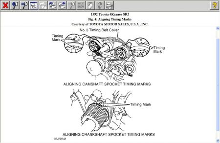

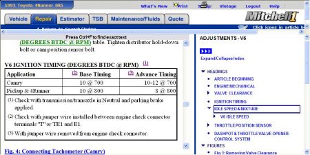

Hi iftihasan, Welcome to 2carpros and TY for the donation
I need to know what timing you're looking for-Is it the valve timing or the ignition timing-check below for V6
