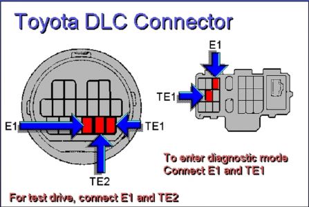

Lets read the codes first and see what the truck says! Here's how: 1988-95: Use a scan tool, or 1. Short terminals of Check Engine connector or service connector (depending on model) with suitable jumper wire. Make the jumper connection between terminals E1 and TE1. Some Check Engine diagnostic connectors are round and are located under the instrument panel. Others are rectangular and are usually located in the engine compartment. 2. Turn the ignitiion ON. Trouble codes will be indicated by flashes of the Check Engine light. Count the flashes to determine the code. If more than one code is present, codes will be separated by a long pause. Codes will continue to repeat as long as the jumper connection remains in the diagnostic connector. NOTE: If the light flashes on and off 4 times a second, there are no codes. DRIVING TEST MODE When a fault is first detected, a code is temporarily stored in the computer's memory. If the same problem is detected again during a second trip, the Check Engine light will come on. In order for this mode to store codes, the ignition switch must be turned OFF between the first and the second test. 1. Make sure the battery voltage is at least 11 volts, the throttle is fully closed, the transmission is in neutral and all accessories are off. 2. Use a jumper wire to connect terminals E1 and TE2 on the diagnostic connector, then turn the ignition ON. The Check Engine lamp should illuminate. NOTE: Test mode may not be entered if terminals TE2 and El are shorted after ignition switch is turned ON 3. Start engine and drive vehicle at 10 mph or higher. If vehicle is not driven vehicle speed signal code 42 and 43 may be set. 4. Simulate driving conditions that originally set code (if possible). 5. Turn vehicle off, remove jumper wire. The rejump terminals E1 and TE1 to read any codes that were set during the test drive. HOW TO CLEAR CODES Disconnect the computer fuse for 10 seconds, or use a scan tool to clear codes.
https://images.2carpros.com/forum/automotive_pictures/62217_95_Older_DLC_1.jpg

I barely understood what you were talking about. So I am going to print out what you said and take it to a shop to get it done. The parts stores scanners don't go back far enough to scan my truck. I've already asked them. So it will be a couple of days before I will be able to get this done. Like I said before I have had a really hard time finding someone who can scan my truck. I will do my best! :)

A Toyota specialist will have zero trouble reading the codes, it only requires a piece of wire and the ignition key!

Sorry but I have one more thing to ask you. You showed me how to check for codes with a piece of wire. Can I get that wire at an auto parts store? Also the diagrams you showed are those my fuse boxes? If you think I can do this myself then I need a little bit more instructions. I just need to know where I can get a jumper wire and where to hook it up. I looked under my hood but I couldn't find them. I am a girl! :) thanks again!

Look under the driver's side of the dash. Use ANY small piece of wire or even a paper clip. Make the connection, then turn the key on and count the flashes.
