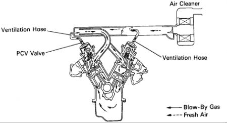

where is the pcv valve located on a 3vze 3.0? Any pics?

PCV VALVE : Top of R.H. engine valve cover
VENTILATION HOSES (TWO) : Top of engine valve covers
