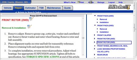

hi to all
i need your help i want to know how to remove the rotor for resurfacing thanks in advance.
