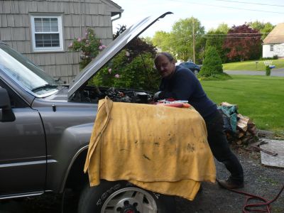

1989 Toyota 4Runner 6 cyl Four Wheel Drive Automatic 169 th miles
This engine ran before I changed bad head gaskets and install new fuel injectors. Problem is Engine will not start. The injector resistance tests ok 13.7 Ohms
Tested injector circuit with NOID TEST LIGHT - Test ok. Can hear injectors clicking while engine is being turned over. Engine will fire , I believe off of cold start injector and then die. At this point I'm out of ideas. Any help will be greatly Appreciated.
