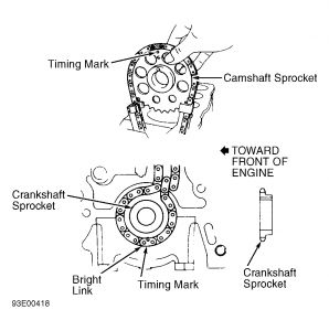

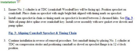

how do you align the timing marks?
Saturday, January 31st, 2009 AT 10:58 PM
MHPAUTOS
MECHANIC
31,937 POSTS
Hi there,
See text and pic for timing chain alignment.
