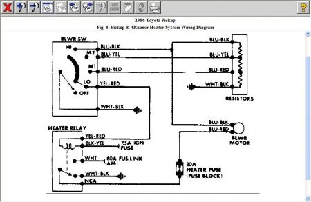

The heater blower only works on the two highest speeds. I already replaced the switch but it didn't make a difference. Do I need to replace the blower motor or is it something else?

Test the blower motor resistor its coming from there see flow chart
https://images.2carpros.com/forum/automotive_pictures/12900_blower_resistor_5.jpg
