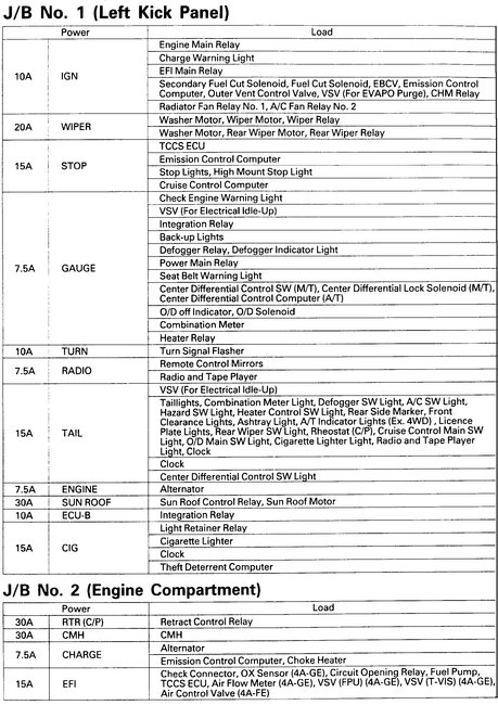

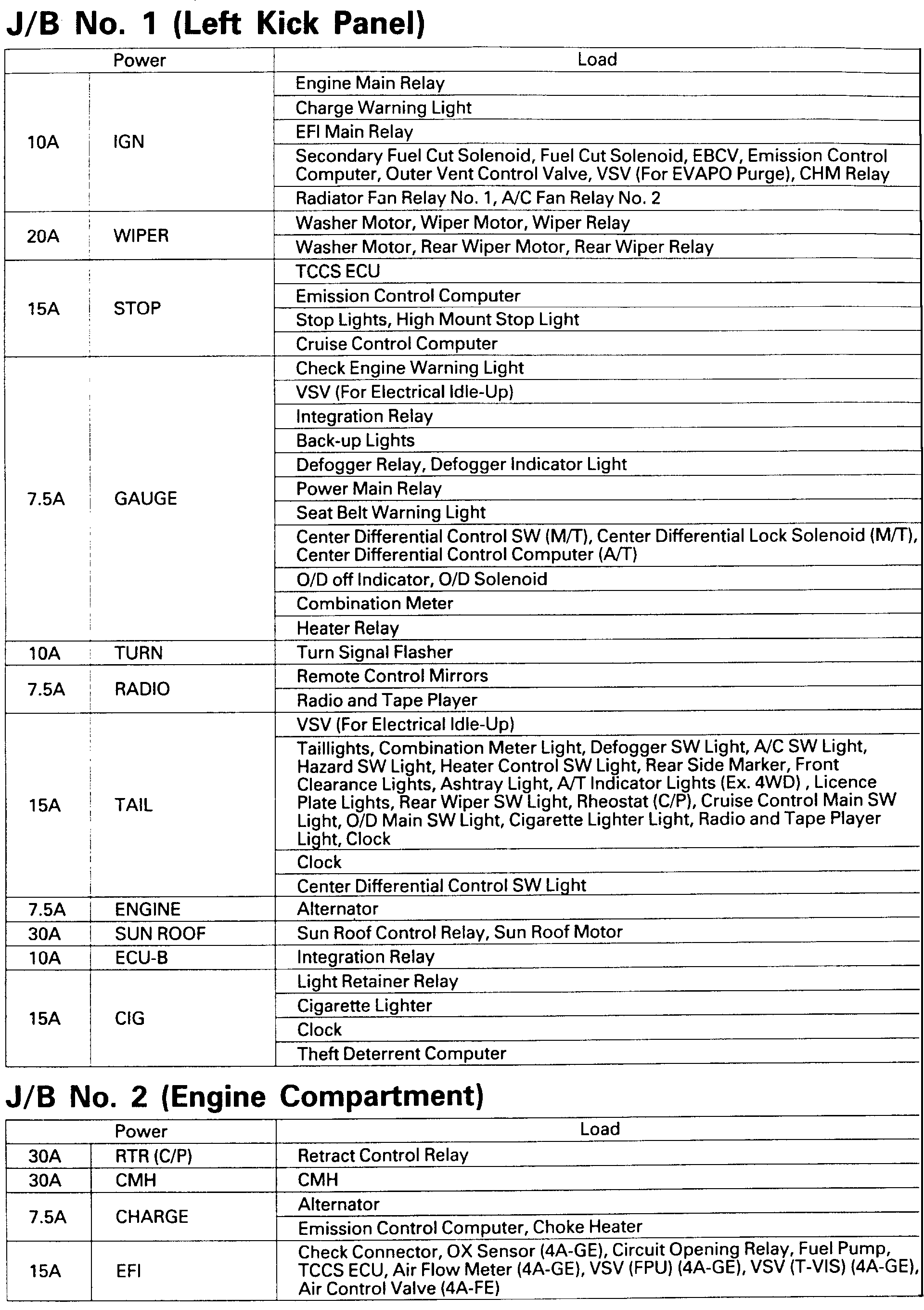

The first thing, confirm that fuse 1 (10 amp) under the dash is good. See picture 2 for a legend of what it covers.

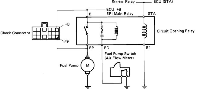

Next, check the fuel pump relay (and circuit opening relay) and connector. The Circuit Opening Relay, located near the ECU, is responsible for providing power to the Fuel Pump. Power is applied to the STA terminal of the relay from the starter when the ignition switch signals cranking mode. This allows the fuel pump to operate until the engine starts and runs under its own power. A signal from the Air Flow Meter (FC), keeps the relay closed until the ignition switch is turned OFF and de-energizes the EFI Main Relay. The fuel pump operation is then interrupted.
I attached picture 1 for you to review. It is a schematic of the relay. Check the connectors mentioned. Also, here is a link that shows how to check a relay:
Do these things first and let me know what you find.

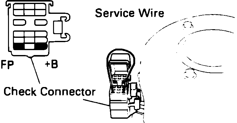

Hi again guys . Made some progress with the troubleshooting and found the ground on the pump was bad and we lowered the tank to inspect and found a loose connection. Fixed that up and still got no power to the pump. Removed the pump and tested it with direct current and it came on. Reinstalled it bridged fp and +b and boom pump came on and we managed to start car . The circuit opening relay is suspectedly faulty . also noticed the engine check light came on as i tried starting again with the bridged link in . Car revvs up and drove with the link but struggled and needed to be warmed up with revving . Car stood for over 6 months and was driven today after so long . How should i go about checking the management light coming on . i also noticed the air sensor on the original airbox isn't there as an aftermarket air intake was installed . could this signal the management? Really appreciate all the great feedback you guys have given and look forward to your advice .

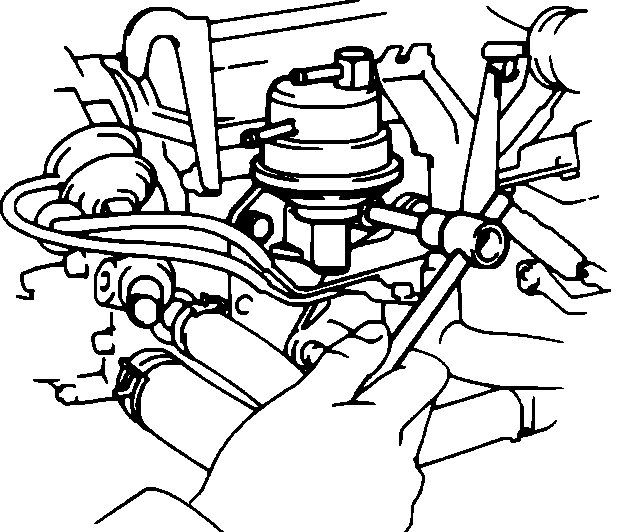

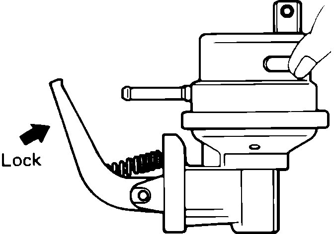

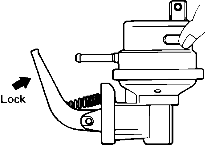

There are different things which can cause this. However, the first thing that should be checked is fuel pressure. Here are the directions for testing. The pictures attached correlate with these directions.
SYSTEM TEST:
1. Using a Tee fitting and fuel hose, connect a low pressure fuel pressure gauge in-line between the fuel pump outlet and the carburetor inlet.
2. Start the engine and observe the gauge readings.
Fuel Pressure: 2.5 - 3.5 PSI
3. If fuel pressure is zero, ensure that the fuel tank has fuel. Also check fuel filter for blockage or restriction.
4. Raise engine rpm to 3,000 rpm and check gauge reading. If a drop in fuel pressure occurs, remove the fuel pump for component testing.
Removing Fuel Pump
picture 1

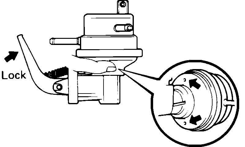

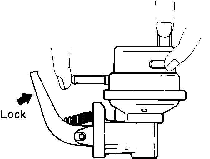

COMPONENT TESTS:

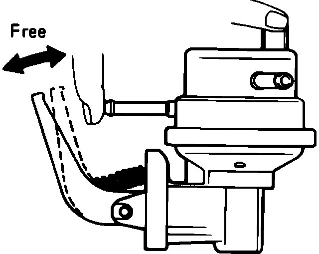

1. With the fuel pump removed from the engine, operate the pump lever by hand and check for excessive arm play tension.
2. Block off the outlet and return pipes with your fingers and check that there is an increase in lever arm play. Ensure that the lever arm moves freely indicating that air is trapped in the pump.
Checking Fuel Pump Inlet Valve
picture 2
3. Block off the inlet pipe with your finger and check that the pump arm is now locked (cannot be depressed easily). DO NOT force the arm to depress.
Checking Fuel Pump Outlet Valve
picture 3
4. Check the pump diaphragm by blocking off all three of the pipes with your fingers and attempting to depress the pump arm. It should lock as in step 3.
Testing Fuel Pump Diaphragm
picture 4
5. If any deficiencies are found, replace the fuel pump.
6. Block off the vent holes under the pump casting with your fingers. Check that the pump arm locks.
Checking Fuel Pump Oil Seal
picture 5
7. If the arm does not lock, the oil seal is bad and the fuel pump should be replaced.
8. Reinstall the fuel pump on the engine cylinder head.

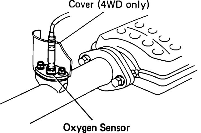

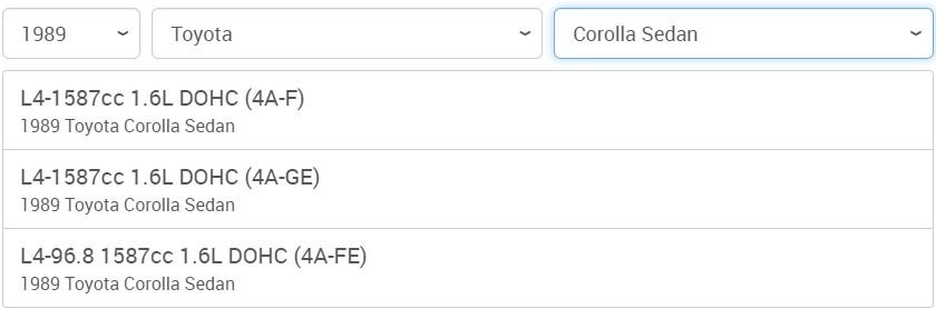

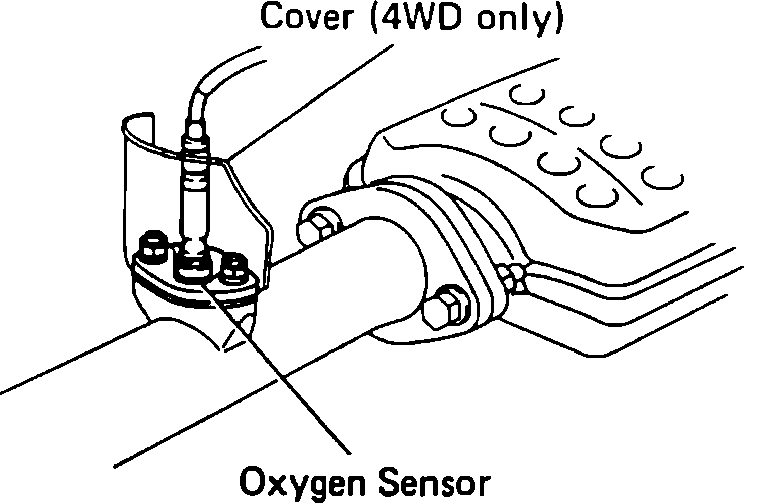

My car is a fuel injected model tvis engine not carburetor? I can still test fuel pressure using the method i suppose? My issue is with the oxygen sensor and if my car actually has one , where it would be situated . Note that it is an Ae92 tvis 1989(Sadm) 1.6 Twincam .
Apr 30, 2019 at 9:18 AM
  • 110,194 POSTS
Welcome back:
If you take a look at the attached picture (1), it indicates the engines in which I have information. Next, all of the engines listed have an O2 sensor. It is behind the catalytic converter. Take a look at picture 2. It shows location. Note that it says 4wd only. That is only for the shield and not the location of the sensor.

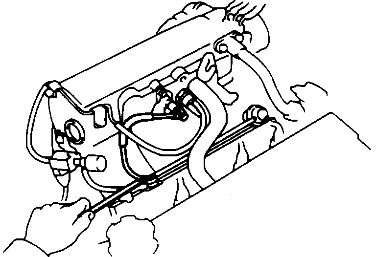

Here are directions for fuel injection. The specs are included and the remaining pics correlate with the directions.
____________________________________
FUEL PRESSURE TEST
FUEL PUMP QUICK CHECK:
1. Check that battery voltage is at least 12 volts.
2. Turn on the ignition switch.
3. Using a service wire, short terminals +B and FP on the engine check connector. The fuel pump should operate.
Shorting Fuel Pump Test Terminals
pic 3
4. Feel the fuel hose coming from the fuel filter to the fuel rail. The fuel flow should be felt, if the fuel pump is operating.
Checking For Fuel Pump Operation
pic 4
5. If not, perform pressure test below.
6. If fuel flow is felt, fuel pump operation is indicated, although fuel pressure may not be correct. For an accurate diagnosis, perform pressure test.

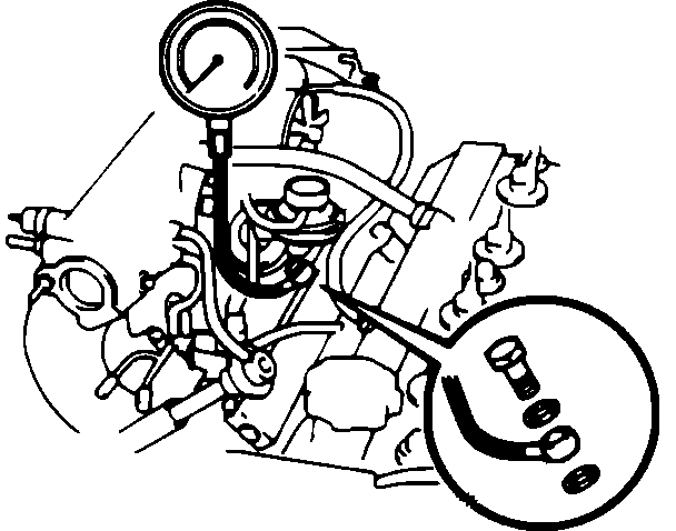

FUEL PRESSURE TEST:
2. Disconnect battery negative terminal.

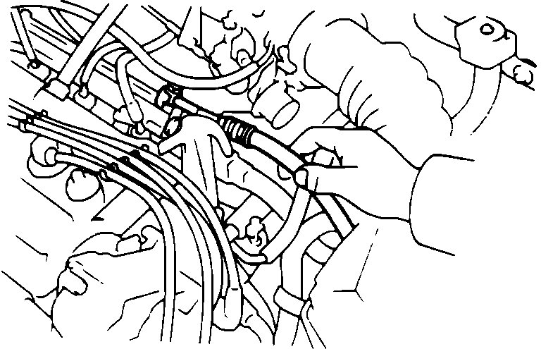

3. Remove fuel delivery pipe between Cold Start Injector and fuel rail. Use caution if the fuel system is still under pressure.
Disconnecting Cold Start Injector Fuel Pipe
pic 5
4. Connect a suitable fuel pressure gauge to the fuel rail using the union bolt and gaskets to provide a tight seal.
Connecting Fuel Pressure Gauge
pic 6
5. Wipe off any gasoline that may have escaped when the fuel pipe was disconnected and reconnect negative battery terminal. Turn on the ignition switch.
6. Using a service wire, short terminals +B and FP on the engine check connector. The fuel pump should operate and cause the pressure gauge to deflect.
pic 7
Fuel Pressure: 38 - 44 PSI (265 - 304 kPa)
7. If pressure is low, check fuel pump output and/or fuel filter for restrictions. If pressure is high, refer to FUEL PRESSURE REGULATOR/FUEL RAIL and test components.
