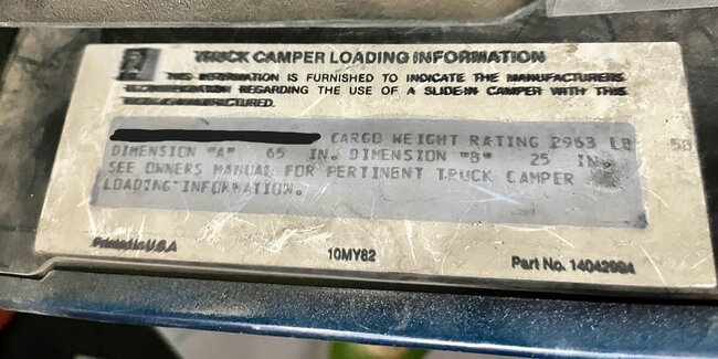

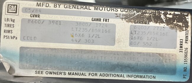

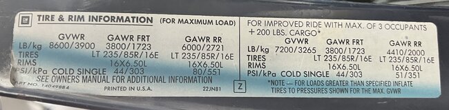

Thanks Brendon. I think I miscalculated; I now have these numbers. Payload capacity max: 3,728 lbs (not including passengers), and Towing capacity max: 9,128 lbs (not including passengers or any payload). I've included the stickers I do have; they may help with calculating. Can you see if those new numbers match up to what you're getting?

Hello TWEBB101,
Thanks for the pics! Let me get into it and see what I come up with for you.

BRENDON S
  • 653 POSTS
Good morning, TWEBB101,
So, your (GVWR) or is the maximum a vehicle can weigh as it rolls down the road which includes curb weight and payload. Without knowing how much the truck weighs empty you can't find the payload. But payload isn't needed because we have the GVRW.
Payload is everything your truck is carrying. This includes everything in the bed and all occupants minus the curb weight.
So, 8,600 lbs GVRW = Curb weight+cargo+all occupants.
In order to find the towing capacity, you will need to subtract 8,600 lbs from the GCWR.
Unfortunately, we don't have that number because the sticker is gone, and the manufacturer doesn't have it anymore either.

Mar 21, 2023 at 9:38 PM
TWEBB101
  • 183 POSTS
Thanks Brendon. I did purchase the towing guide, and I found the 1984 Chevy Truck vehicle information kit from GM Heritage as well. The towing guide says that the GCVWR is 14,000 lbs. The Heritage kit says the curb weight (minus passengers/cargo, just truck and fluids) is 4752 lbs. I'm happy to send those to you if needed/wanted.
