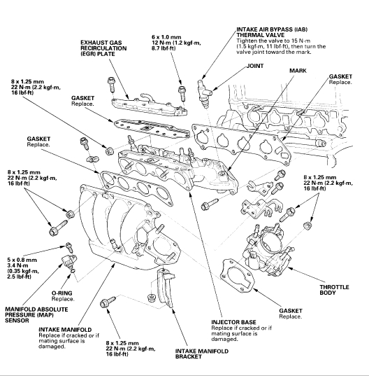

Was wondering if you could tell me the torque specs for the intake manifold bolts? much appreciated in advance!

Hopefully this will help you out. Your bolts should be on there.
Image (Click to enlarge)
