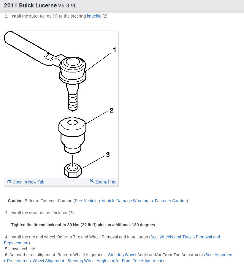

Torque specs tie rod end.
Wednesday, August 17th, 2022 AT 10:50 AM
SQM
MECHANIC
6,383 POSTS
The outer tie rod end lock nut needs to be torqued at 22 lb. ft. Then turn another 180 degrees.
See attached.
Let me know of any questions.
