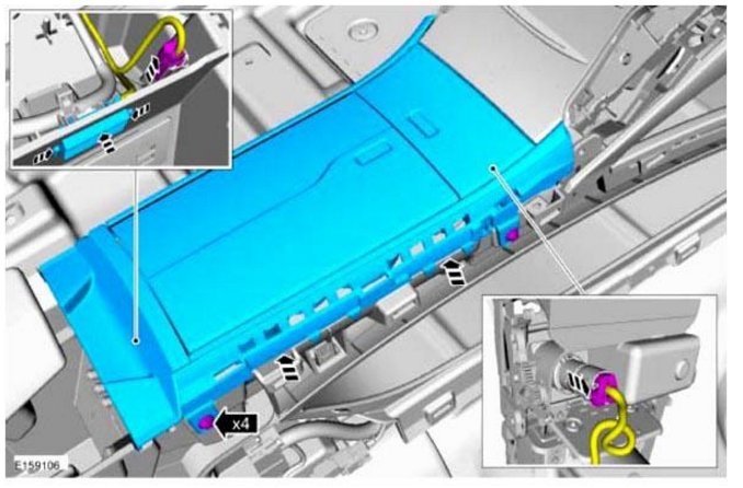

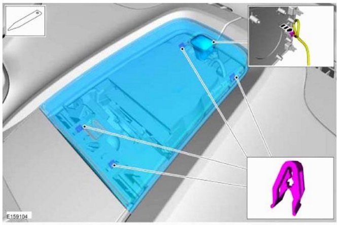

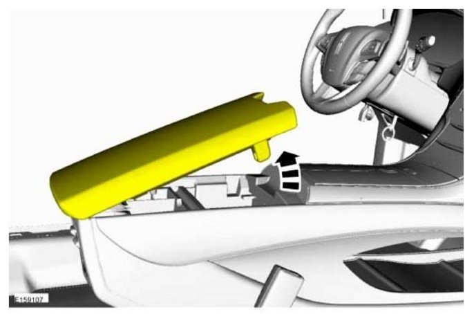

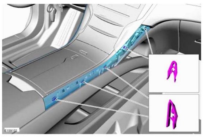

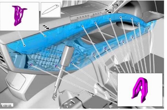

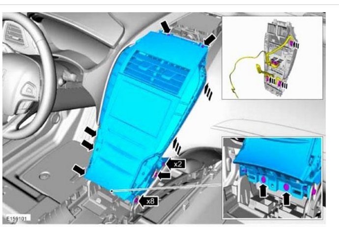

I wanted step by step instructions on how to replace the center touch screen in my car listed above. Thank you.
Dec 28, 2016 at 1:34 AM
  • 55,711 POSTS
Hey HPATELW5,
Start by disconnecting the battery, there are a series of plastic clips and torx screws. here are some diagrams that will help you remove the touchscreen.
