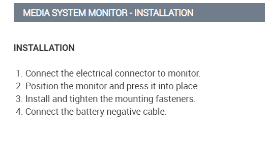

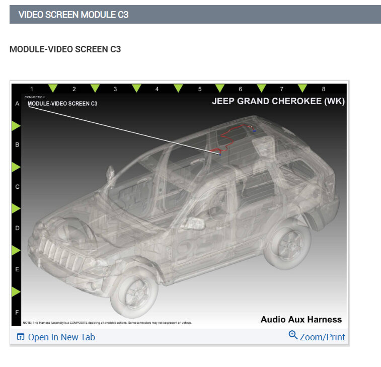

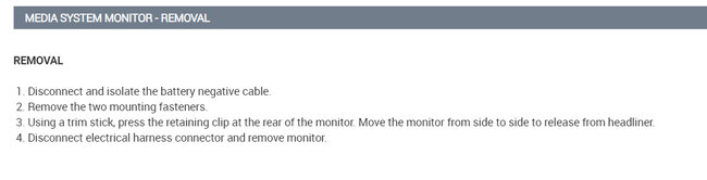

Here is the location and how to replace the unit in the images below. Check out the images (below). Please let us know what happens.
