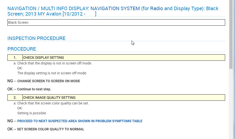

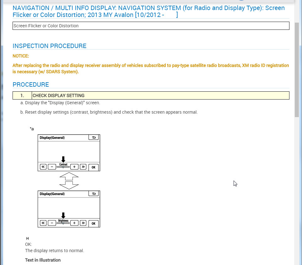

When i start the car the touch screen display is fading then when i drive a little while it restores back and it happens always. It got worse today when i put the car on reverse all i see is a white screen but after a while of driving it restored back.
May 24, 2020 at 4:27 AM

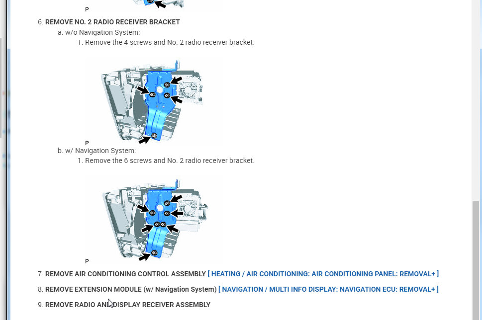

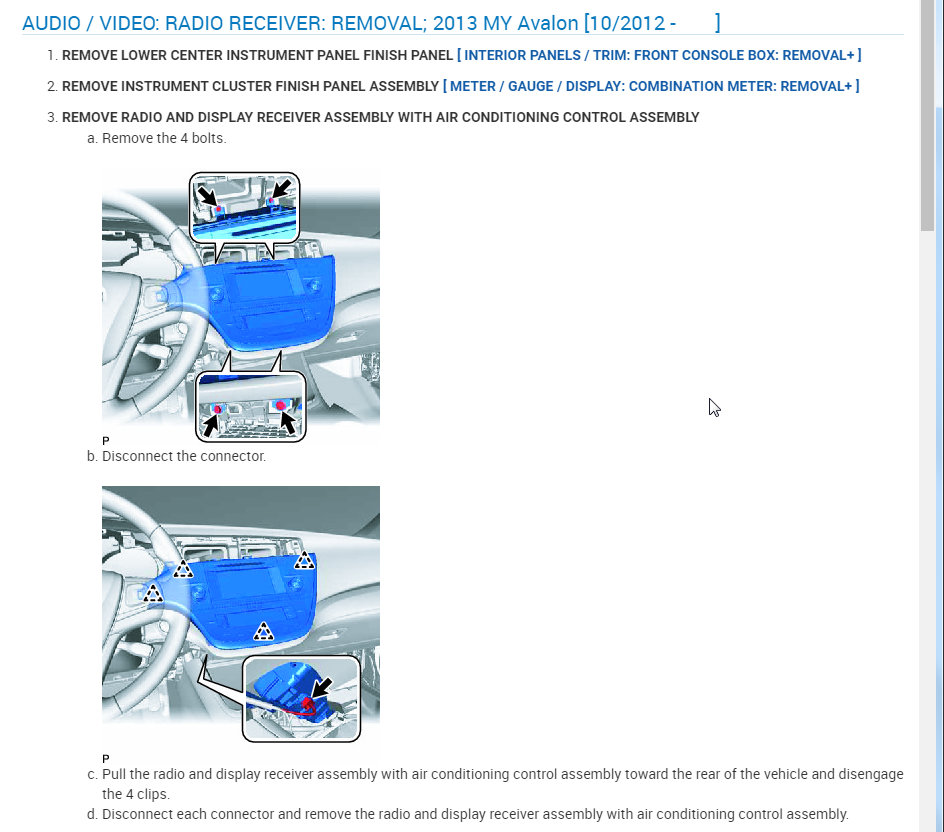

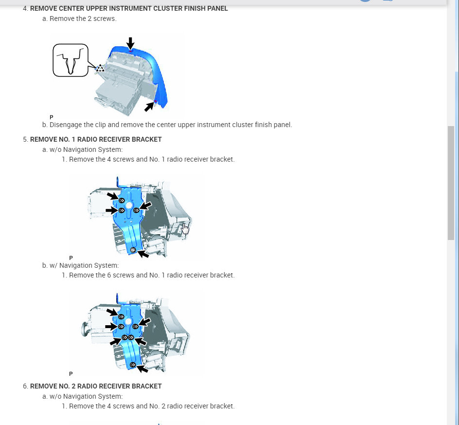

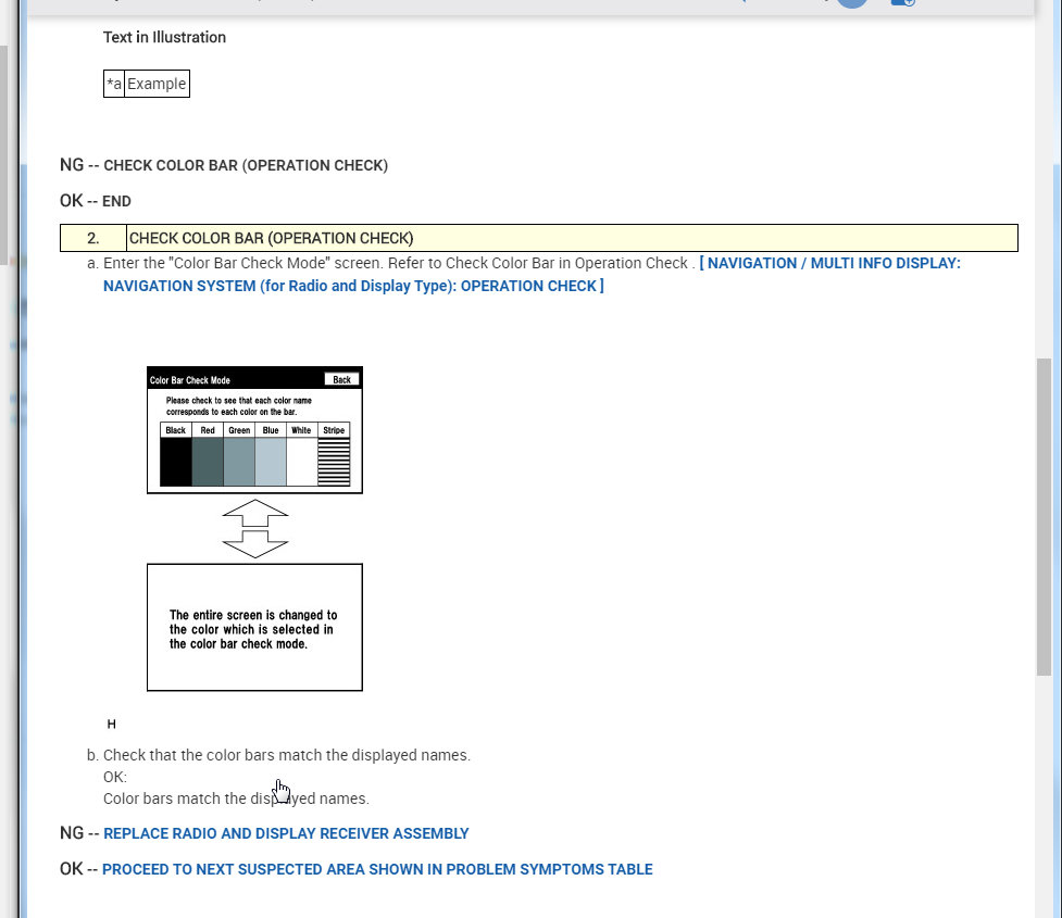

I suspect you are going to need to replace the display receiver assembly. However, we need to run through this testing and see what turns up. The fact that it returns or did return tells me the module is the issue.
Let me know if you have questions and we can go from there. However, I included the process on how to replace this assembly.
