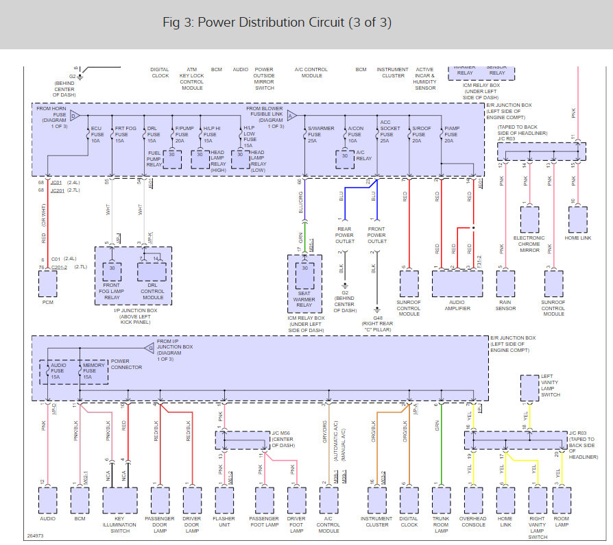

Car is completely dead:
-The battery is good (battery tested, freshly charged over night, 12.7 volts on multi-meter, and just to check, nothing changes when jumpers from a running car are attached). Connections are good and clean.
- no hazards, no headlights, no dash lights, no "click", no nothing.

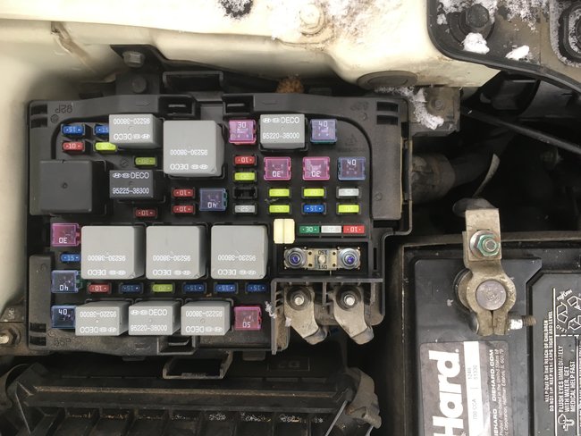

I have a power probe and have tested all blade type fuses (inside and engine bay fuse boxes). I cannot see a way to test the square fuses with the plastic hoods. I have never seen a 150 amp "fuse" like the one in this box, but I did a continuity test across it.
I have verified voltage at the ignition (heavy gauge incoming red wire).
What happened: My daughter drove home, no symptoms; turned off the engine, and couldn't extract the key. Attempted to restart the car to adjust the steering wheel thinking it was locking the key. Totally dead.

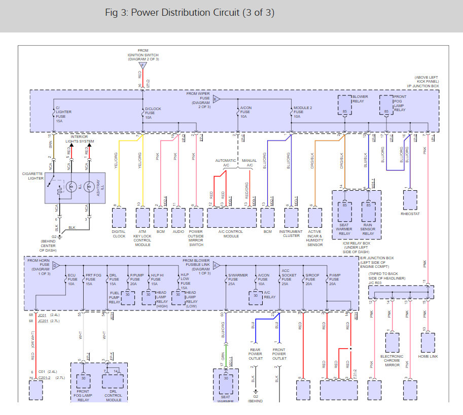

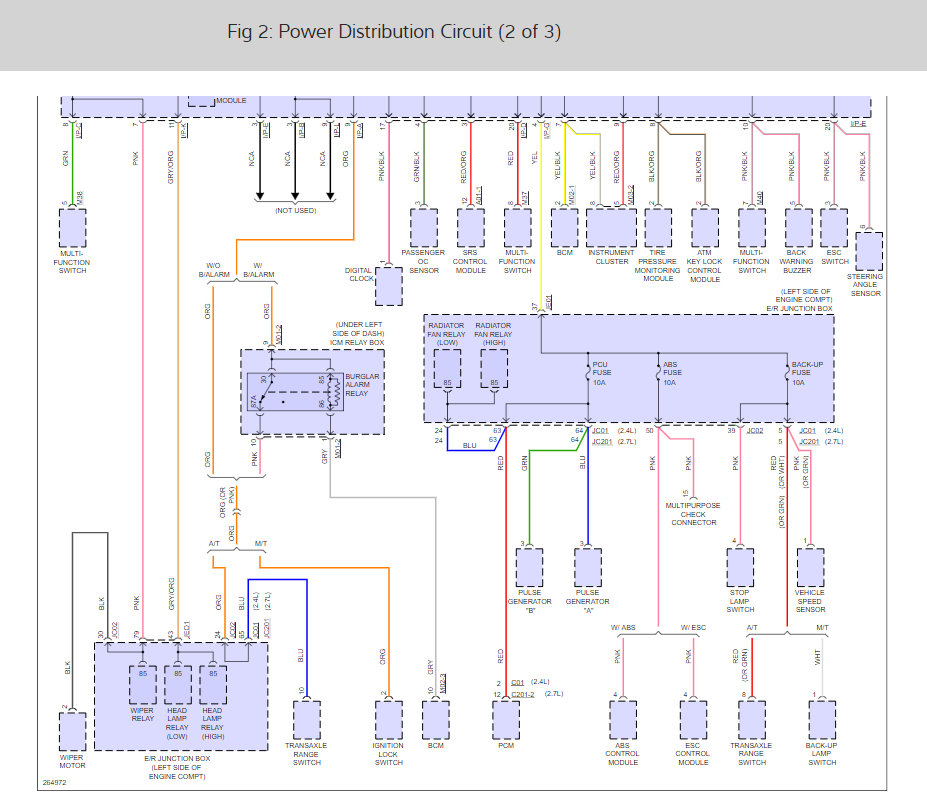

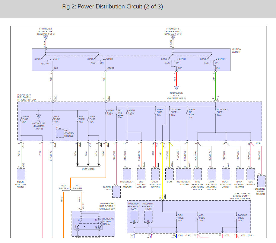

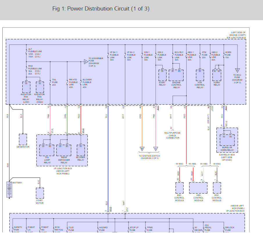

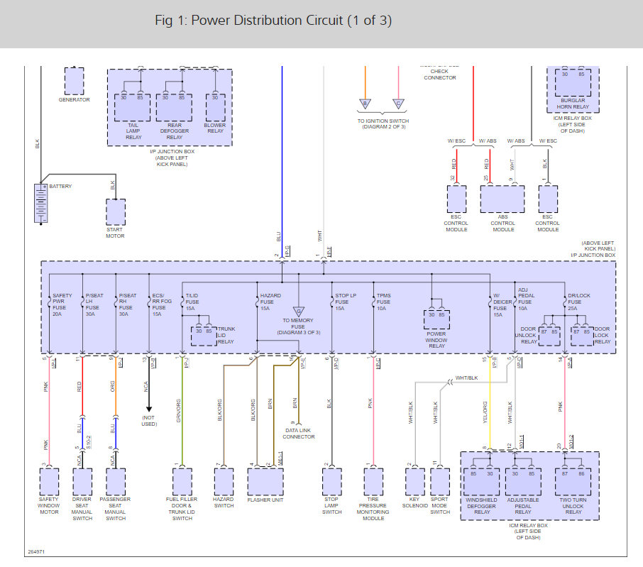

it sounds like the ignition switch has gone. bad but to be sure here is a guide to help you test the power through the switch and the wiring diagrams to help you see how the system works:
Also make sure the battery cables are clean and tight.

The wiring diagrams are excellent.
I have a multi-meter and a power probe, and some experience with automotive and electrical.
I tested all the fuses and fusible links in the engine bay fuse box and the kick panel fuse box. I removed the fusible links, tested for them for continuity, and verified 12V incoming to one terminal, then re-seated.
I verified 12V in to the kick panel fuse box (thick light yellow wire, single terminal connector)
I verified operation of the ignition switch in all key positions: 12V in on orange and pink, and 12V out on the ACC/ON/START key positions
