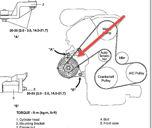

I need to know if my alternator is on the top or bottom of my engine please.

The alternator is on the bottom. Here is a guide and the diagrams below so you can see how the job is done.
https://www.2carpros.com/articles/how-to-replace-an-alternator
Check out the diagrams (Below). Please let us know if you need anything else to get the problem fixed. Cheers
