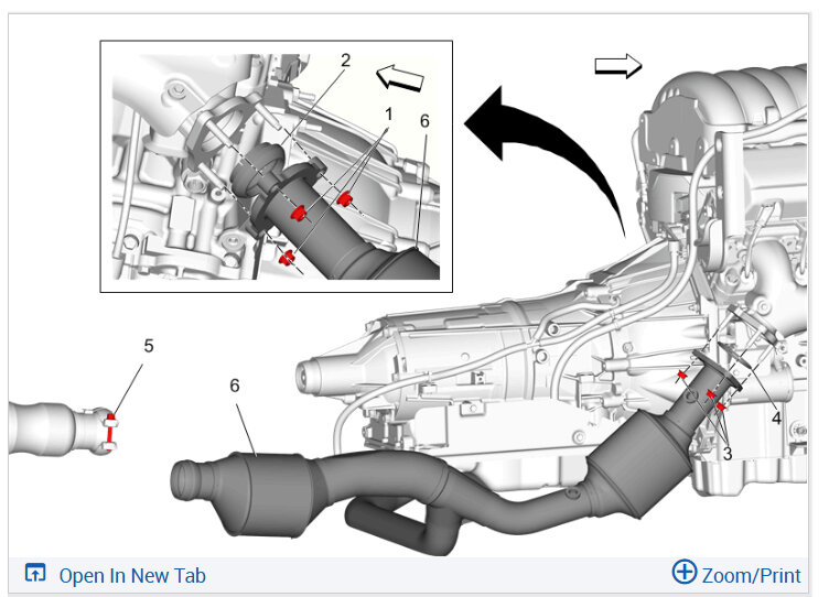

Okay, it sounds like the catalytic converter on the driver's side is clogged. This code" P0107 - Manifold Absolute Pressure (MAP) Sensor Circuit Low Voltage" is a clue.
Here is a guide to help you see what is going on:
You might want to loosen the head pipe to see if the engine runs better. Check out the images (below).
Mar 27, 2025 at 1:45 AM

The cats have been deleted.
Mar 27, 2025 at 5:06 AM
  • 55,549 POSTS
Sorry, you mention that above. I would fall back on the tune/PCM then, there is nothing else I can think of that will cause this. You have fuel, spark and compression. Did you get a chance to look at the spark plugs?
