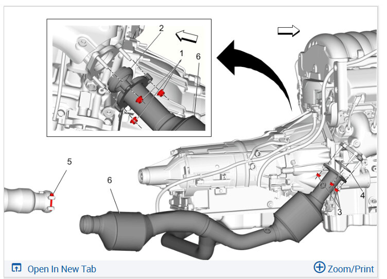

Okay, it sounds like the catalytic converter on the driver's side is clogged. This code" P0107 - Manifold Absolute Pressure (MAP) Sensor Circuit Low Voltage" is a clue.
Here is a guide to help you see what is going on:
You might want to loosen the head pipe to see if the engine runs better. Check out the images (below).
Mar 27, 2025 at 1:45 AM
TERRY V
  • 6 POSTS
The cats have been deleted.
