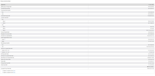

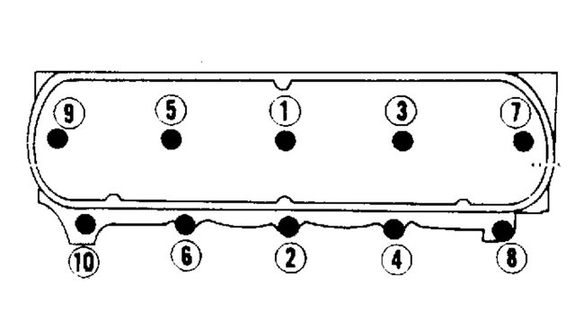

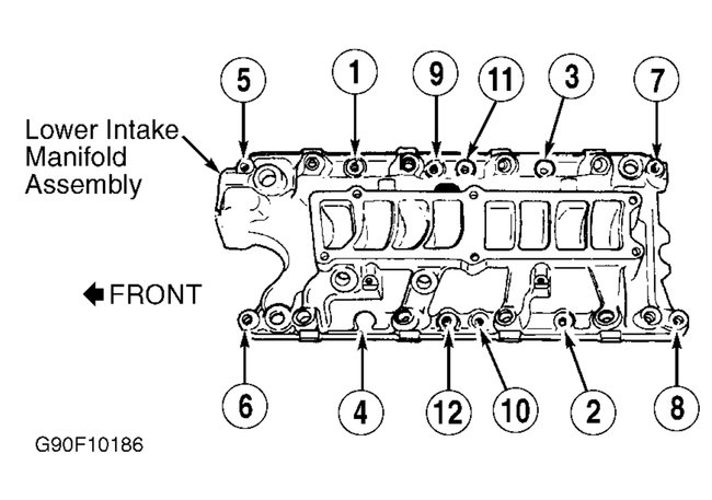

I keep getting different torque values and sequences for a Ford 302 engine. It is not a boss engine or HO engine. Could you please give me the correct sequence and values for the internal bolts and the intake bolts as well as the sequences where necessary. Thanks
Aug 7, 2017 at 8:14 AM
RYAN L
  • 272 POSTS
I think I found what you are looking for! Thank you so much for using 2CarPros! If you need anything else please let me know. Check out the diagrams (Below). Please let us know if you need anything else to get the problem fixed.
