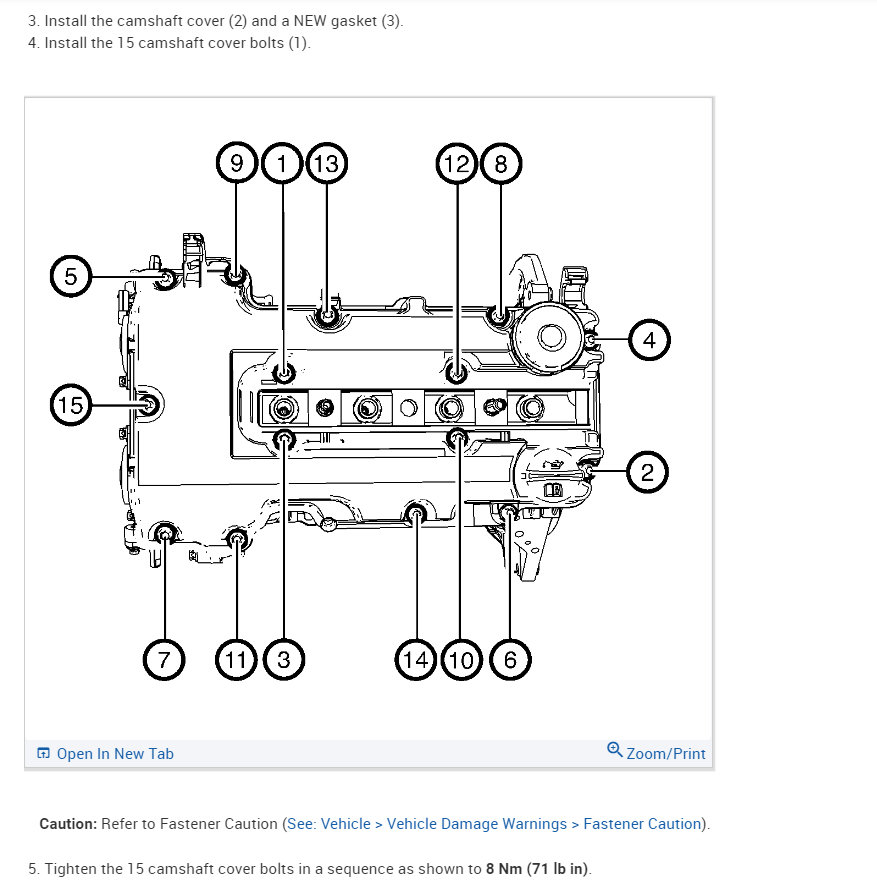

Torque values and sequence of valve cover?
2011 CHEVROLET CRUZE
120,000 MILES • 1.4L • 4 CYL • 2WD
DSHEM153
MEMBER
1 POST
Replacing valve cover gasket.
Sep 4, 2022 at 1:43 AM
AL514
Experienced Mechanic
5,700 POSTS

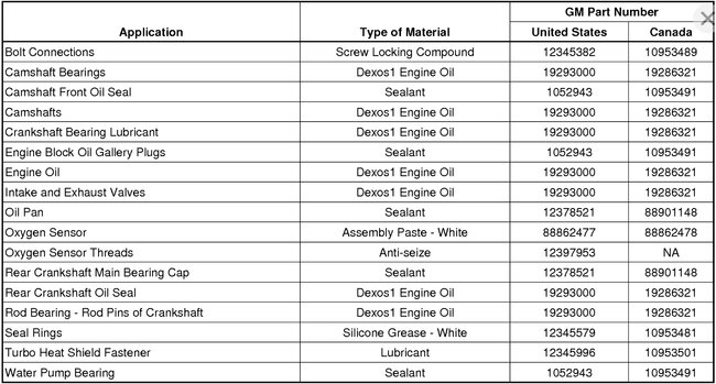

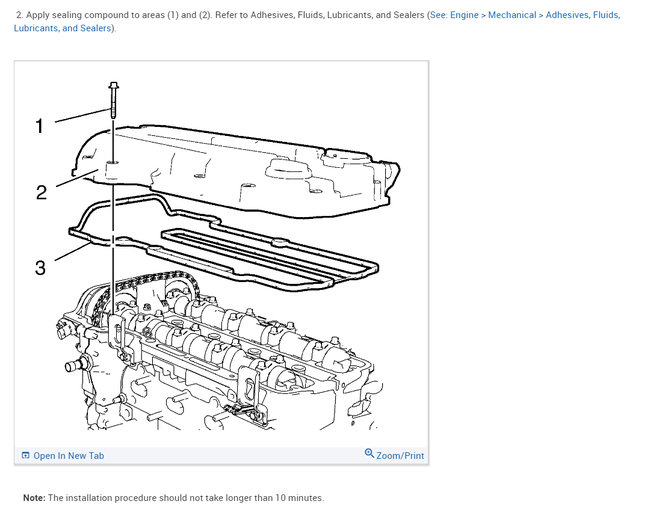

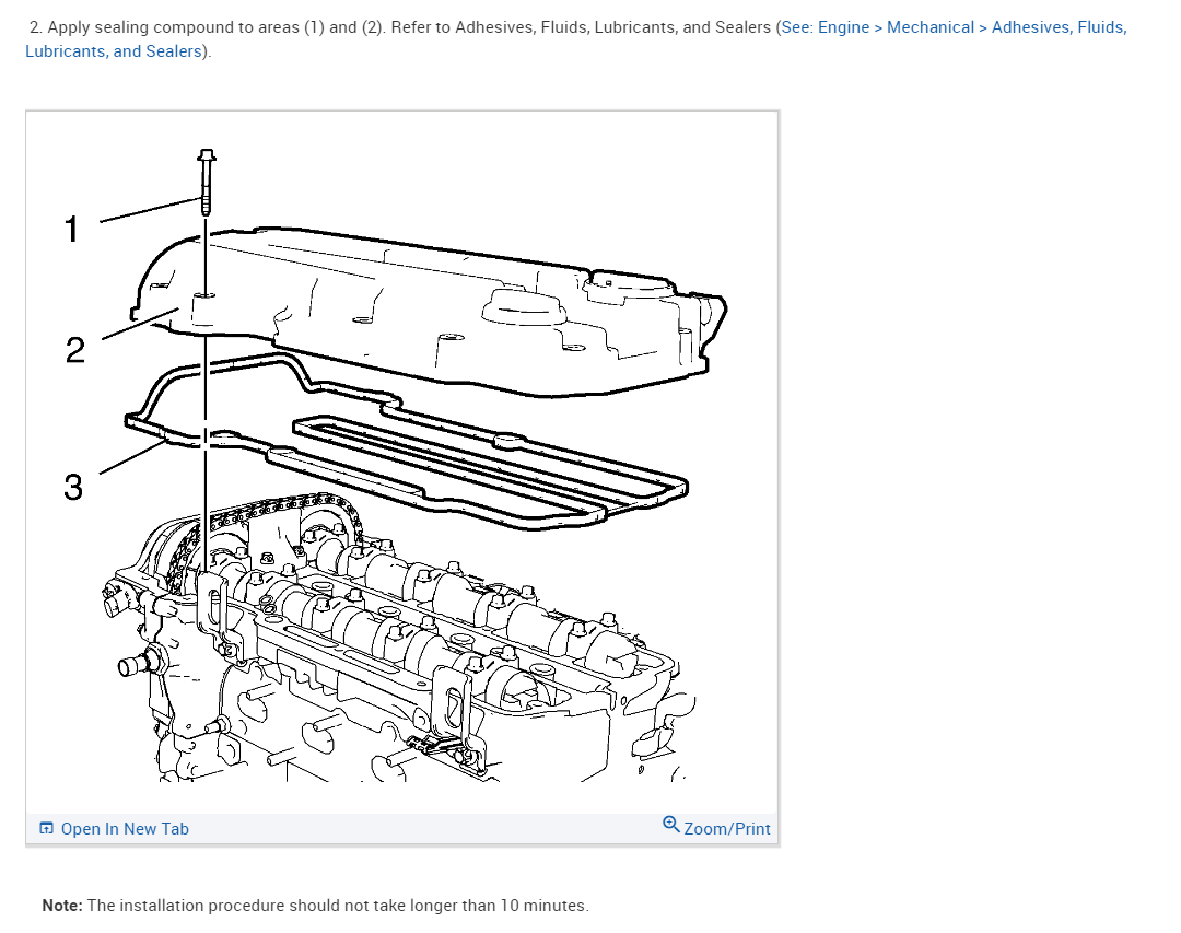

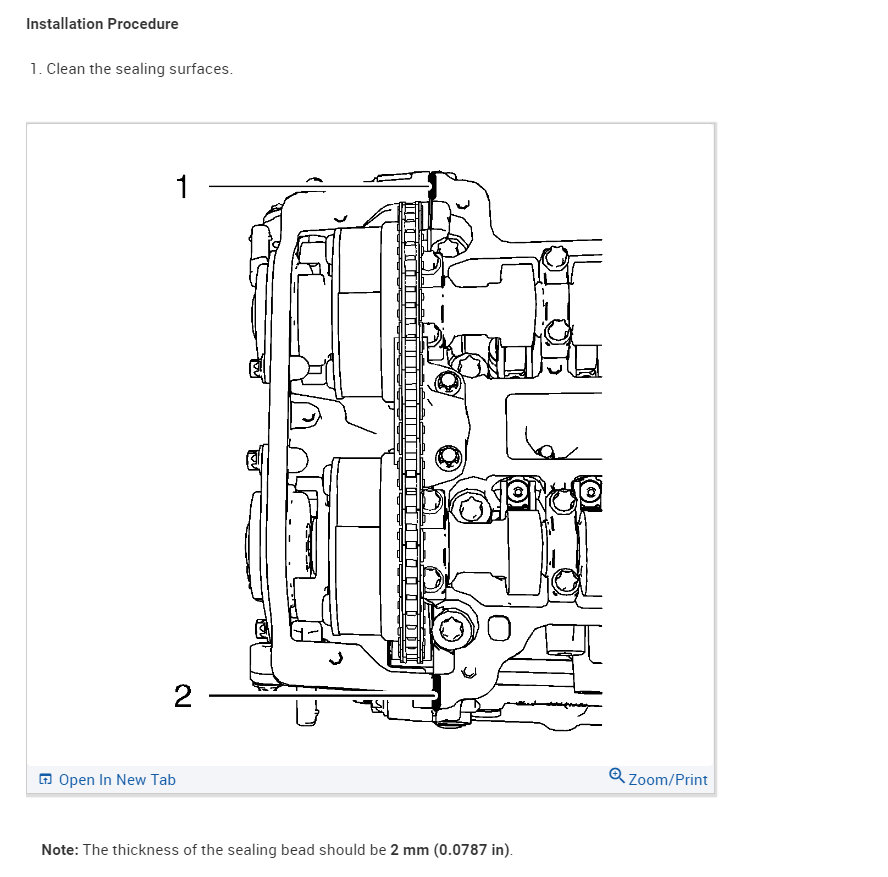

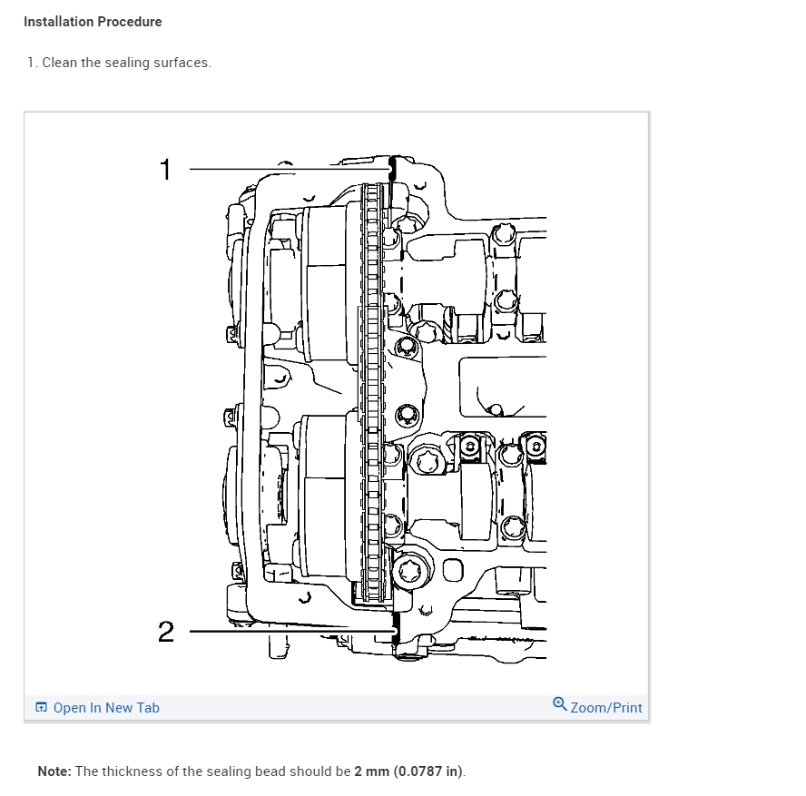

Hello, here's the procedure and torque specs. I'll pull up the sealing compound for the corners as well. There's a list but they do not mention the valve cover corners, but an RTV sealant will work on those 2 small places...
https://www.2carpros.com/articles/replace-valve-cover-gasket
