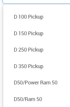

I'm looking for the torque values for inner and outer tie rod end nuts and the center link nut to the pitman arm and idler arm for this vehicle. Thanks.

I would be happy to help but first I need more information about what kind of truck you have. I've attached a picture below.Get back to us with your information and we'll go from there.Thanks for using 2CarPros.

Danny, D150. Thanks.

Those are all to be torqued to 80 ft-lbs. Just remember to tighten additionally to align castle nut to the hole to insert cotter pin and not loosen to align.Hope this helps and thanks again for using 2CarPros.
