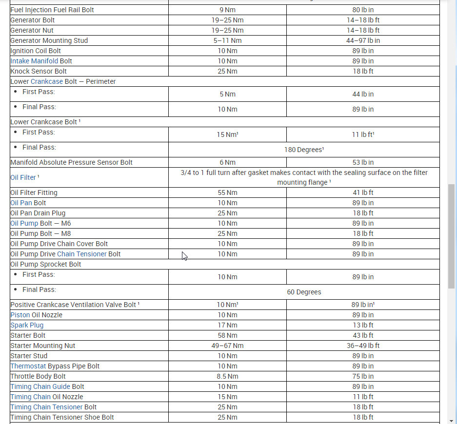

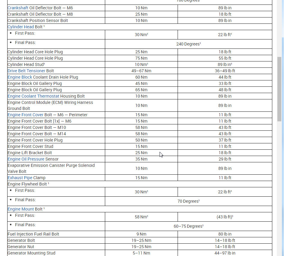

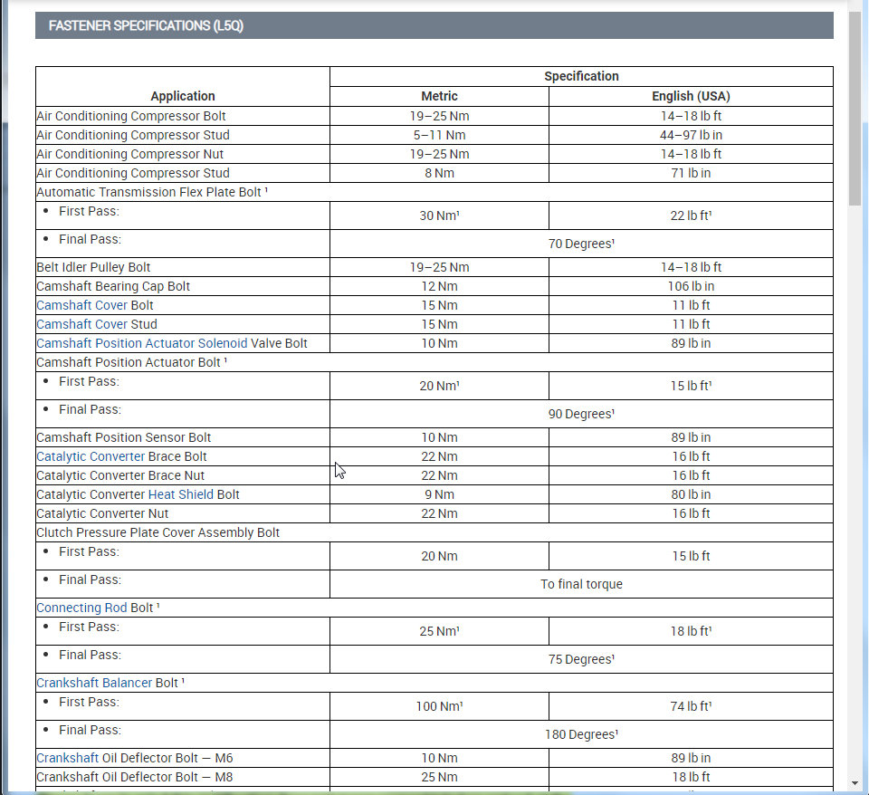

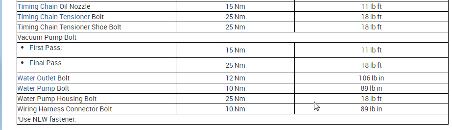

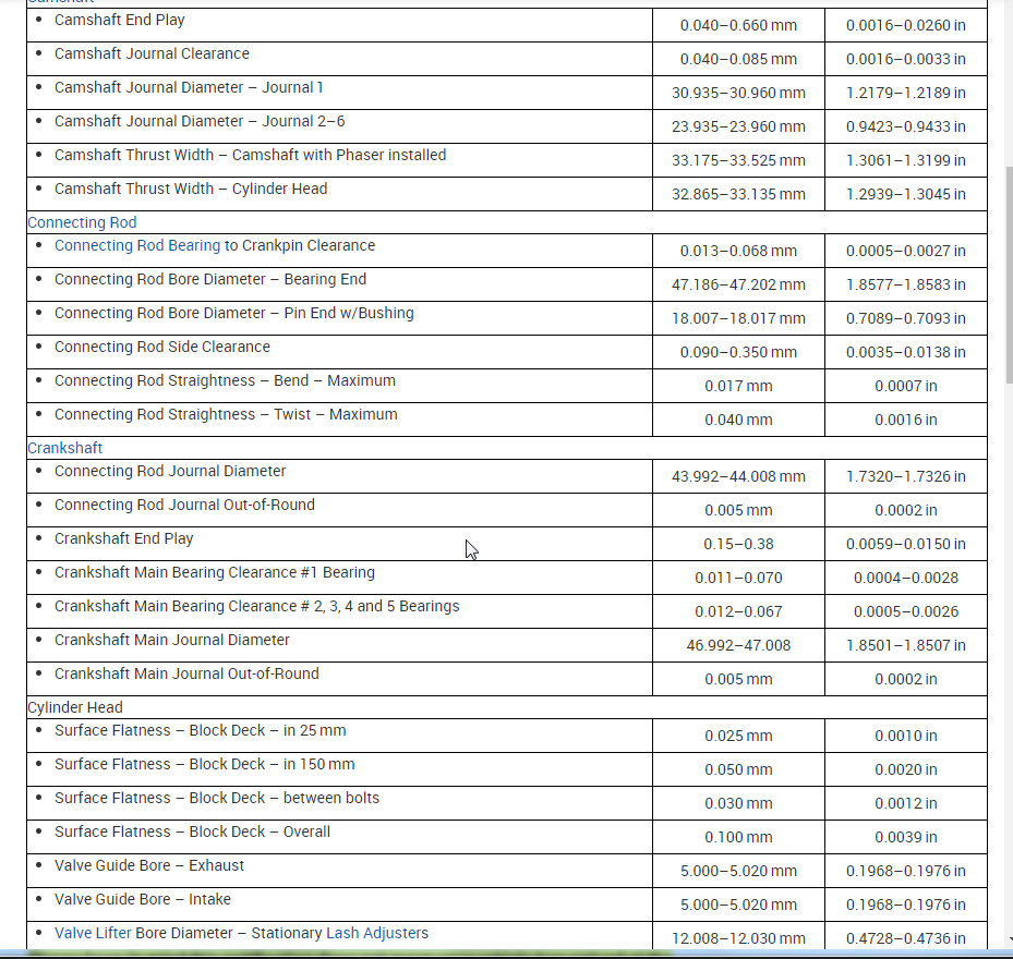

torque specs needed for main and big end bearings and head bolds and camshafts
2016 CHEVROLET SPARK
95,762 MILES • 1.2L • 4 CYL • 2WD • MANUAL
RAHRAH LUDICK
hi, i need the torque setting for the main and big end bearings and also the head bolds and camshafts torque settings.
Feb 22, 2021 at 6:16 AM
I am attaching most all the specs for this engine in case you need something else. Please let us know if you have other questions. Check out the diagrams (Below). Please let us know if you need anything else to get the problem fixed. Thanks
Feb 23, 2021 at 8:58 AM
