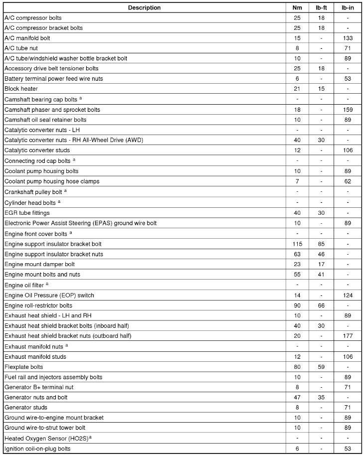

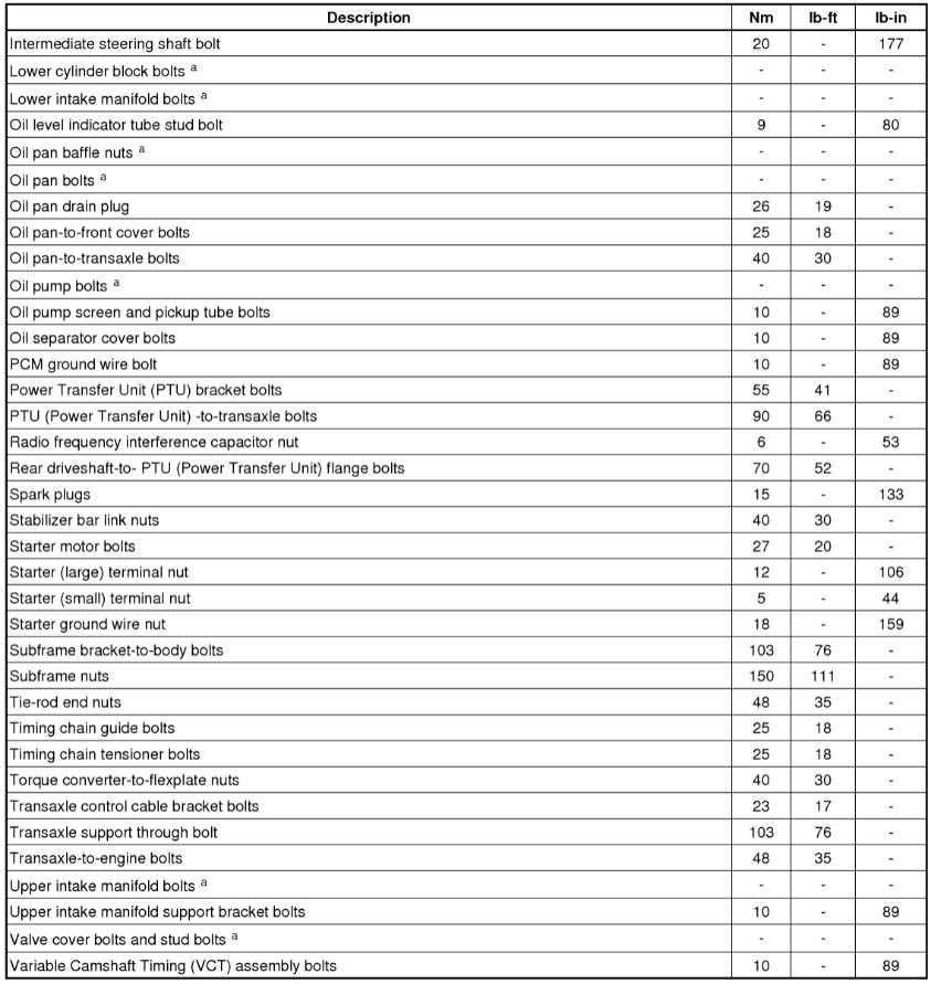

Torque specs for upper and lower intake manifold needed
2012 FORD FUSION
161,000 MILES • 3.0L • 6 CYL • 2WD • AUTOMATIC
GAVIN JAMES
As well as the fuel rail and the EGR valve and I need them in inch lbs please.
Aug 12, 2021 at 10:59 AM
STEVE W.
  • 15,349 POSTS

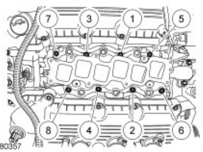

Lower intake is 89 inch pounds in two stages 40 - 89 pattern in first image.

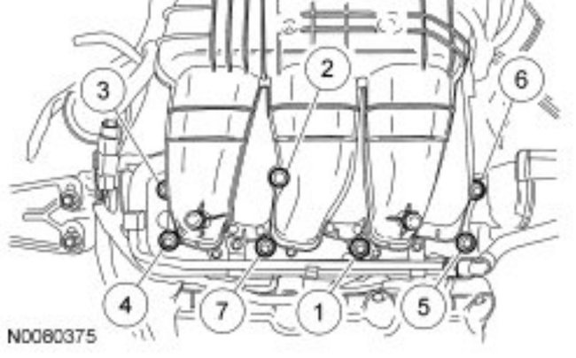

Upper is 2 stages as well, 89 inch pounds then 45 degrees pattern in second image.
Rail and injector bolts are 89 inch pounds.
EGR tube fittings are 30 FT lbs.
